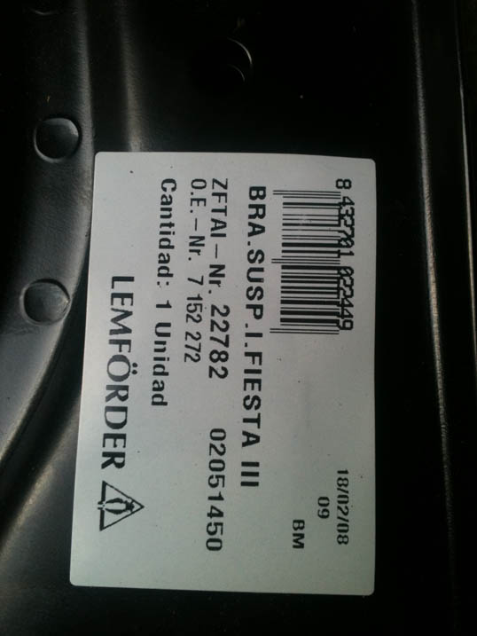

So i got some decent stuff, as only stuff i could put it down to was this: Lemforder wishbones and genuine top mounts/bearings.
Just for your information, lemforder is brand of zf, they supply to many car manufacturers including ford, bmw, vag, merc etc. There parts are very good.

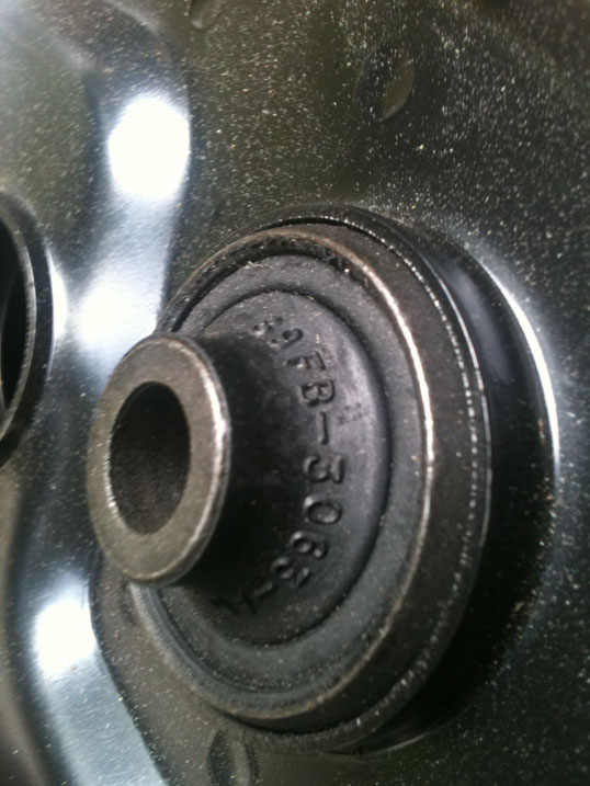

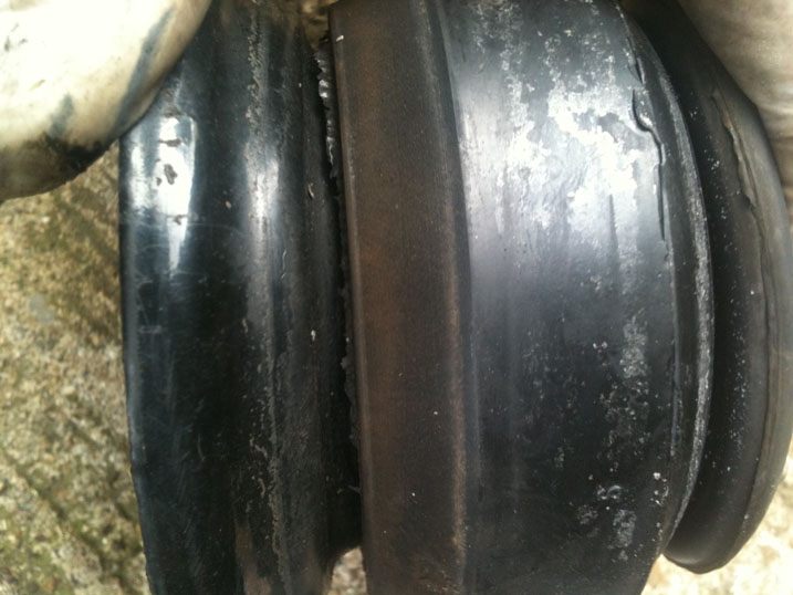

The part number on the wishbone bush is a ford one, made by boge, boge is also a brand of ZF
The problem with the cheap wishbones seems to be that the bushes unglue from the wishbone, creating movement.

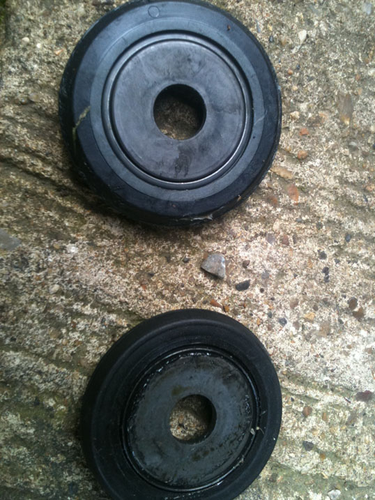

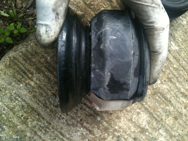

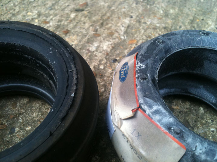

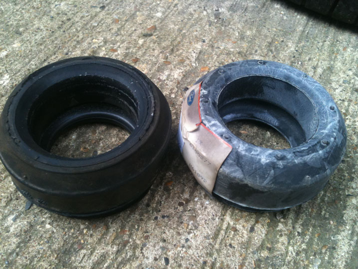

Top mounts.
As you can see the cheapo ones are worn quite a bit, making lots of movement.
And they sit differently on the top spring cup, which cant be helping things:

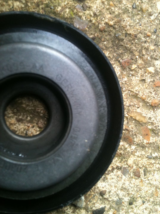

Bearings.
Made in germany. I know they cant win the war, but theyre pretty dam good at building cars/parts.
The cheapo ones where rough as .......
You cant really see it but the cheap ones dont seem to seal up the bearing properly.

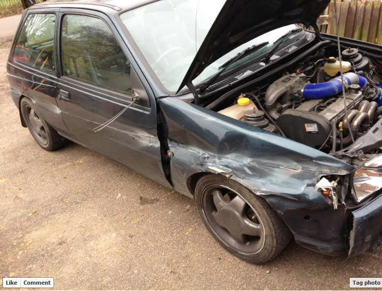

Travelling home on the M4 sat morning after picking up a lsd box, someone cut out in front of me and i braked heavily, locked up and ended up in the central reservation.
Luckily i managed to not hit anyone else, im ok. But pissed off, no one stopped, i had to pay 150 quid recovery to get me of the motorway too.
Repairable, dont think its bent chassis but untill the front wings off i just dont know.

:( :( :( :( :( :( :( :( I have a brand new gen ford wing that side mate, :( :( got mirrors is that the bumper I sold you the other week? I scrapped the si last week with ur old bonnet on it :( should have kept it now :(

i still got the bumper i got from you, will have the wing tho.
needs to find a genuine rear quarter

Tbh mate once you have a look you can pretty much guarantee there will be structual damage :(
