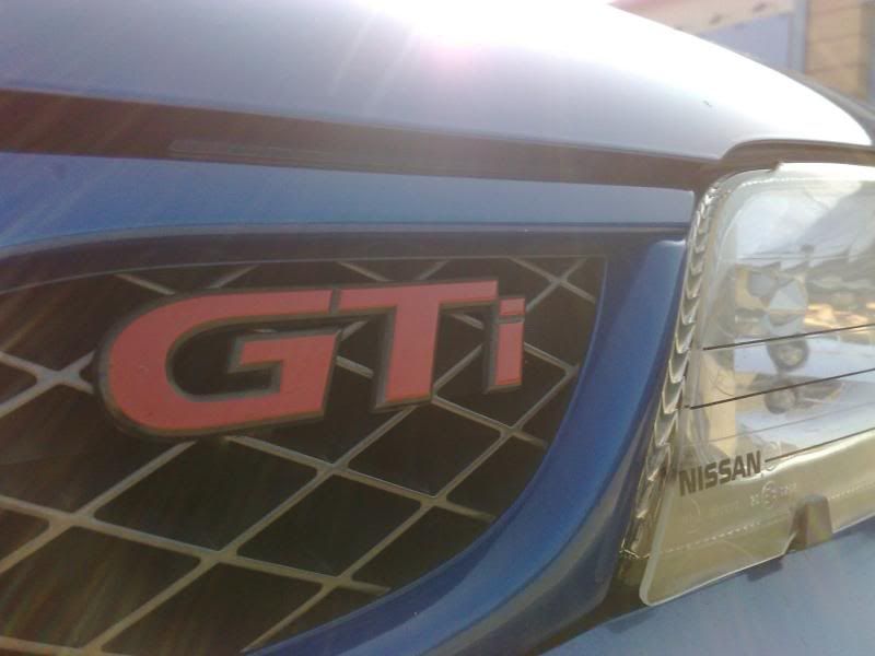

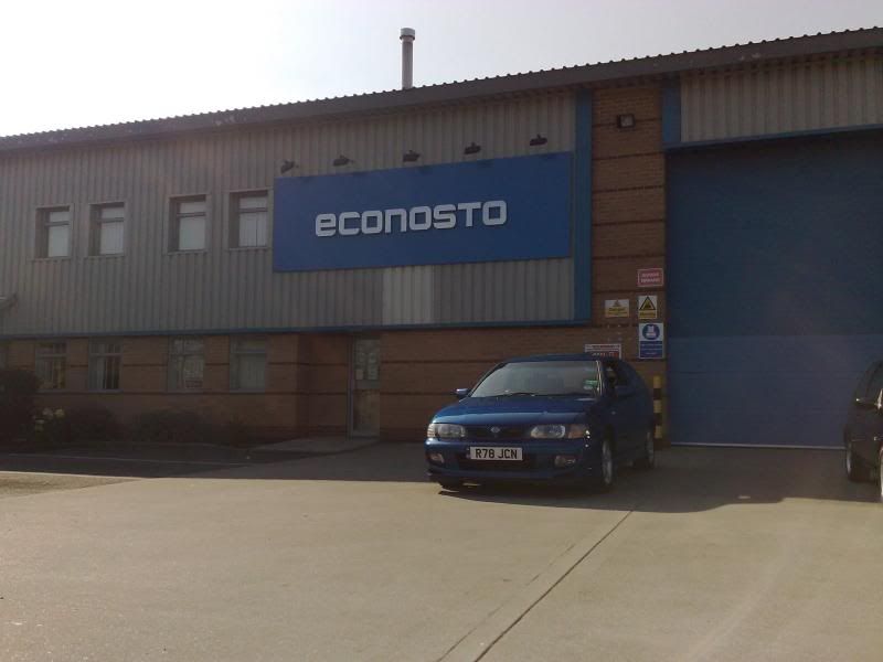

Heres some pics from the weekend....comments appreciated as always.
Big thanks to all for help with the diagnosis of the misfire :FSI:

PostPosted: Mon Apr 26, 2010 10:15 pm
good pics mate
PostPosted: Mon Apr 26, 2010 10:41 pm
Awesome pics buddy, car is looking beautiful! 8-)
Good news that you have decided to go for the conversion, bet you cant wait to get it all sorted now :chill:
