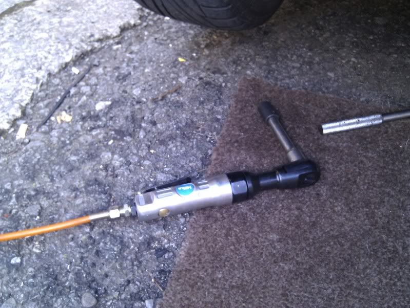

firstly my valentines day presant, handy little air ratchet, does upto 50lbs/ft at 150rpm, so goo enough for your average nut and bolt, will be buying a impact socket soon
buying these now as we recently was given a broken compressor we repaired easily

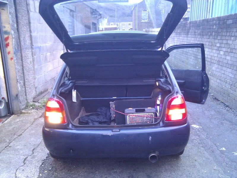

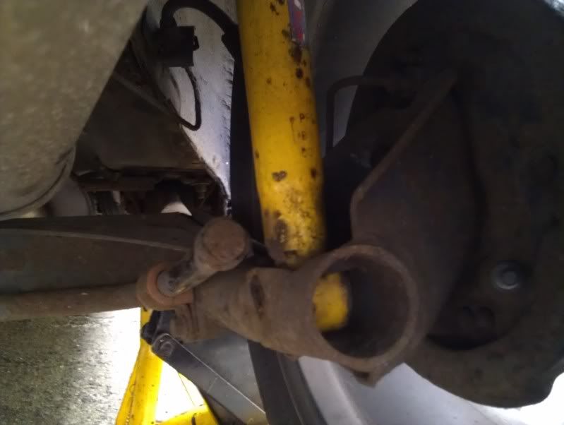

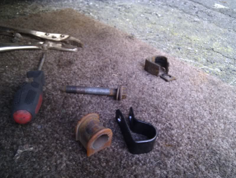

first job was the rear ARB bracket that had snapped some time ago, only noticed it when i changed the suspension, so thanks to Tom peters (FT.com) for providing these at unbelievably quick postage speeds

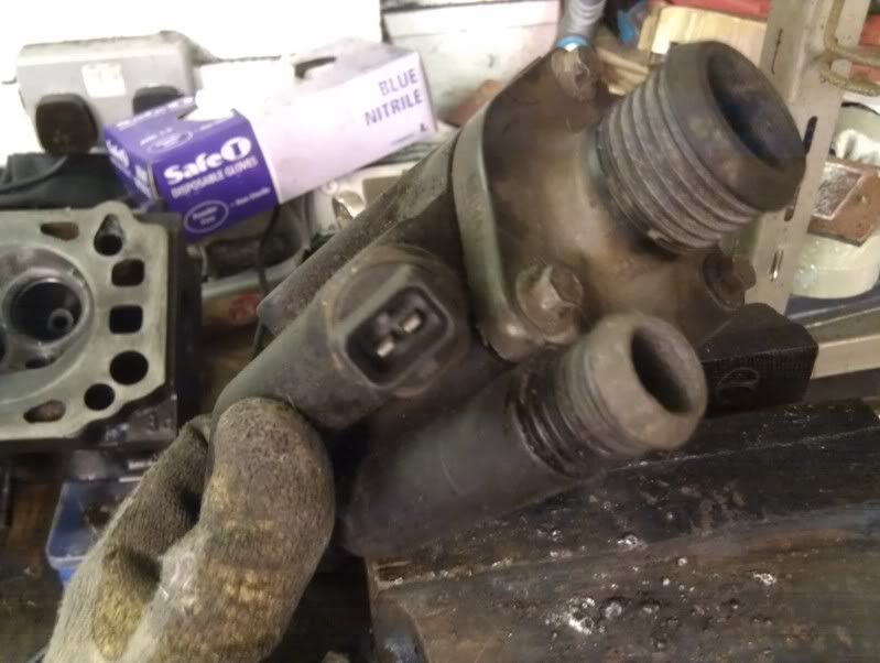

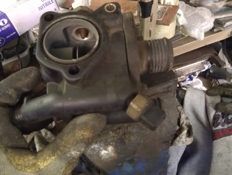

Does anyone knob what sensor this is? only noticed it when digging around and ive never changed that on my car when trying to route out my idle issue

as for the sensor, fuck knows:P
those arb brackets ford stock?
PostPosted: Wed Feb 15, 2012 9:05 pm
yup genuine ford, even had the ford part number stickers, do you need some?

That sensor may be for the temp gauge
PostPosted: Wed Feb 15, 2012 9:25 pm
ill unplug it and see what happens :P

think mine are ok tbh buddy but i know ford stopped making them didnt they?
pretty sure someone on here got some made up, stainless steel so the same doesnt happen to them!
PostPosted: Wed Feb 15, 2012 11:26 pm
thinking about it, the 1.4 si didnt come with a rear anti roll bar mate
but yea there is two different rear brackets, one fits to the shock bolt,
the other just bolts to the beam, these are the beam ones, the one thats discontinued for the shock bolt has a spacer in it
i simply added a piece of the old broken bracket to space it (as it already has the bolt hole)

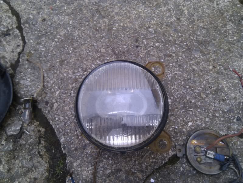

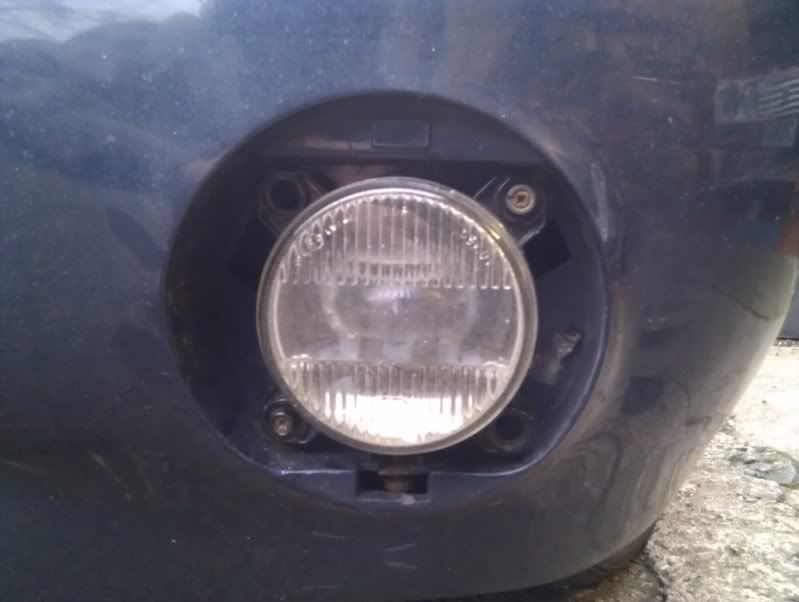

bought a spare fog lamp a few weeks back and decided to pop it on today
mine was franked as it was lacking enough mounts to hold it steady, the new one has all 4 brackets, so stops it swinging around!
new one in and my bulb tranfered over

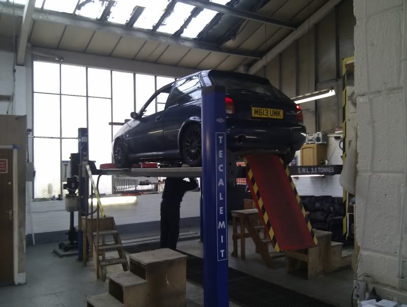

PostPosted: Sat Feb 18, 2012 3:21 am
Bad news...
she fail the MOT
3 things:
corroded steel rear near side brake pipe = easy
nearside rear chassis leg corroded within range of beam mounting = bitch to do as its tight and my arc welder aint for underneath cars
offside rear chassis leg corroded within range of beam mounting = " " "
a number of advisories, but nothing sinister
bit gutted really went in confident i done all that was needed, dont know how i missed the holes
decided not to rush it, thinking about getting the free retest etc, no point as it will only skimp and come back to haunt me
so putting a list of tools needed together, borrowing the dosh and im going to do it proper!
which includes the beam coming off, rear arch kit coming off and time spent, got myself some metal from a mate, its galvanised too so thats good, and will be buying some red oxide too!
once the capri is running and out, im getting tempory cover on it, use that to get around, and this will be going in the garage to get sorted, no deadline but preferably a month as the capri only is taxed till end of march...
