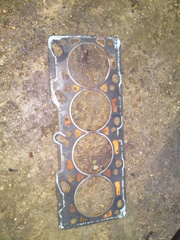

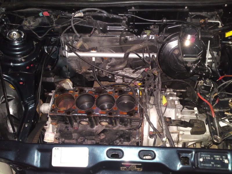

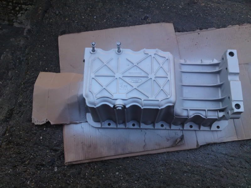

well on saturday my mate took the cylinder head :shock: :)
cylinder 1 failed on the head gasket :doh: explains the water being burnt off

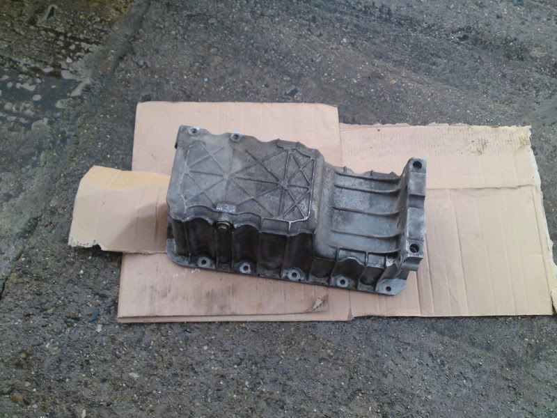

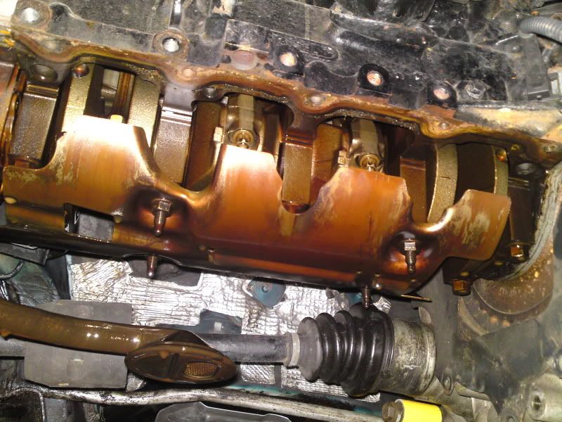

also drained and took the sump off, when the sump plug was undone water came out first then the oil :hmm:
which was all brown and mushy
with the sump off it needed a massive clean as it was soo gunky and sludgy, also going to take the pick up pipe off and clean that at the weekend
and while it was off i decided prefect time to give it a freshen up
before
after
also bought some stainless steel bolts and washers for the sump

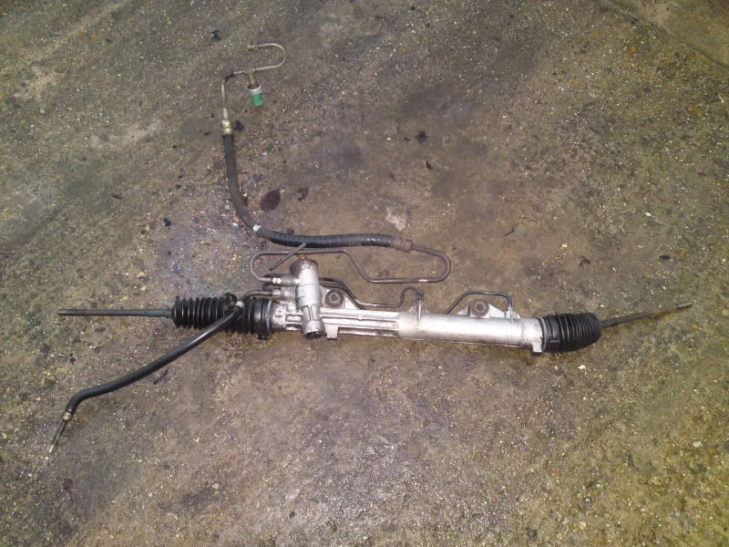

also jam took the pas rack off and its now gone down the tip! :P
just the front anti roll bar left now

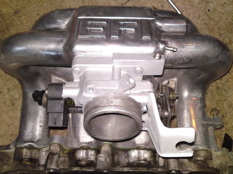

also painted the exhaust manifold, im not sure if it will last but i used heat proof paint for up to 500 degrees :doh: but not to bothered about it
also painted the throttle bodie as i real liked how dans came up so thought i gotta give it a go :) i would have had it polished to go with the rest of the engine bay but i can't afford it, but this way cleans it up nicely :)
thats it for now, but at the weekend the steering should be pretty much manual :)

Getting there Phil! Throttle body came up alright didnt it! What paint did you use on your manifold? Halfords stuff? Only reason I ask is because I have heard bad reviews about their head resistant paint, apparently it just cracks, peels or burns off. Never know, you might get lucky!
Have fun cleaning the internals up! Made a bit of a mess didnt it! :(

I have used the same paint as you mate so keep an eye on my thread and ill see how long that halfords paint lasts lol, as you said zetecs run hotter than the other engines, so will be interesting 8-)
