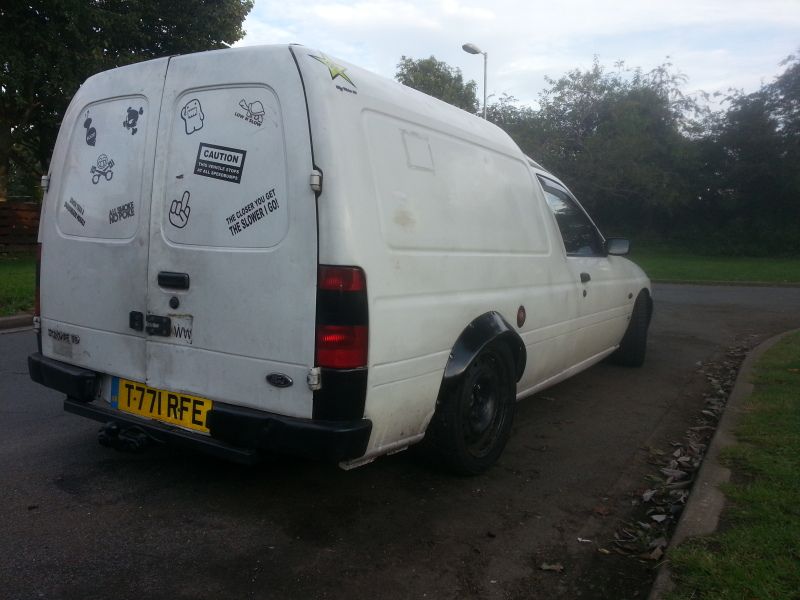

Awesome stuff! perfect amount of stickers although "no illegal immigrants left in this vehicle overnight" is a good one!

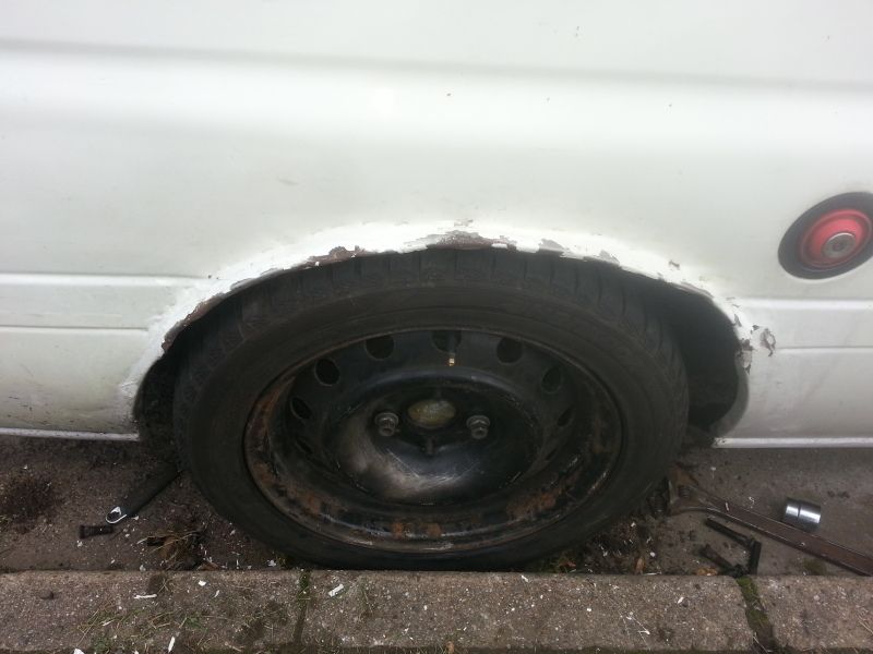

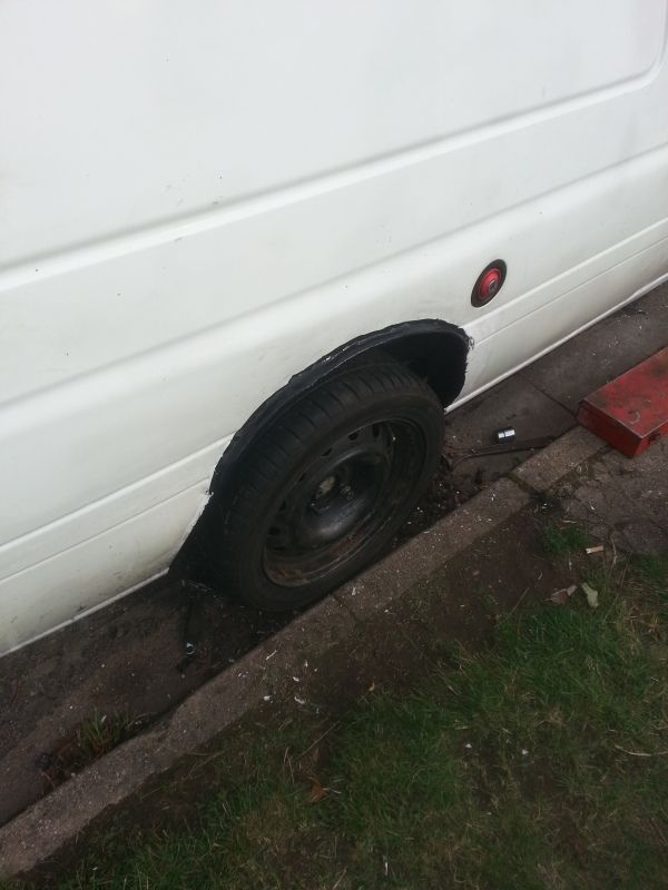

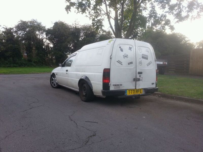

So my only updates are this:-
Citroen 15 inch steels, 195 50 15 tyres, 20mm spacers and longer studs
Oh and universal jdm arches, and some bastardisation.
Still need to fit the fronts after I sort the tyres out.
And also going to remove the rear ones, cut the arch lips off, sealer them up and refit, because I scrub.

PostPosted: Sun Sep 02, 2012 3:12 pm
Looks awesome, its almost heading towards looking quite ratty lol
 Post subject: Re: Scrote Van - Oh yes.
PostPosted: Sun Sep 02, 2012 3:19 pm
It is ratty, up close the arches look shit.
could of the rivets were bodged in because the drill slipped and ripped some of the fiberglass off lol

The extra rear track of around 50-60mm in total makes it hilarious on bends.
On the way to work taking bends like a go kart at motorway speed lol

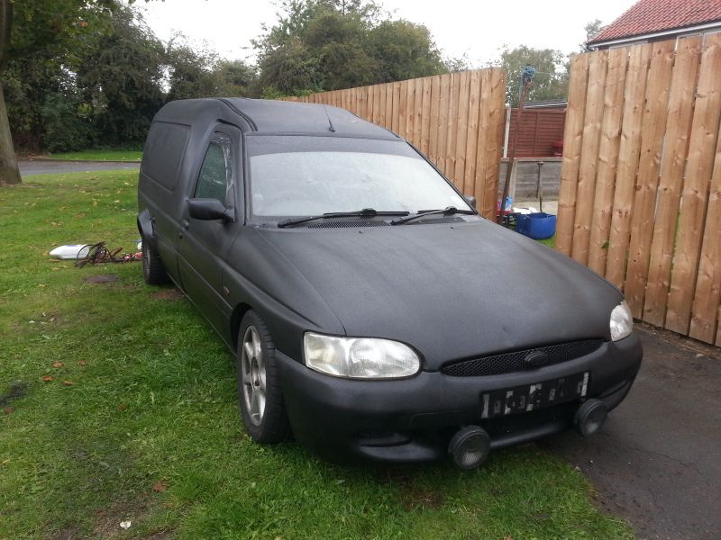

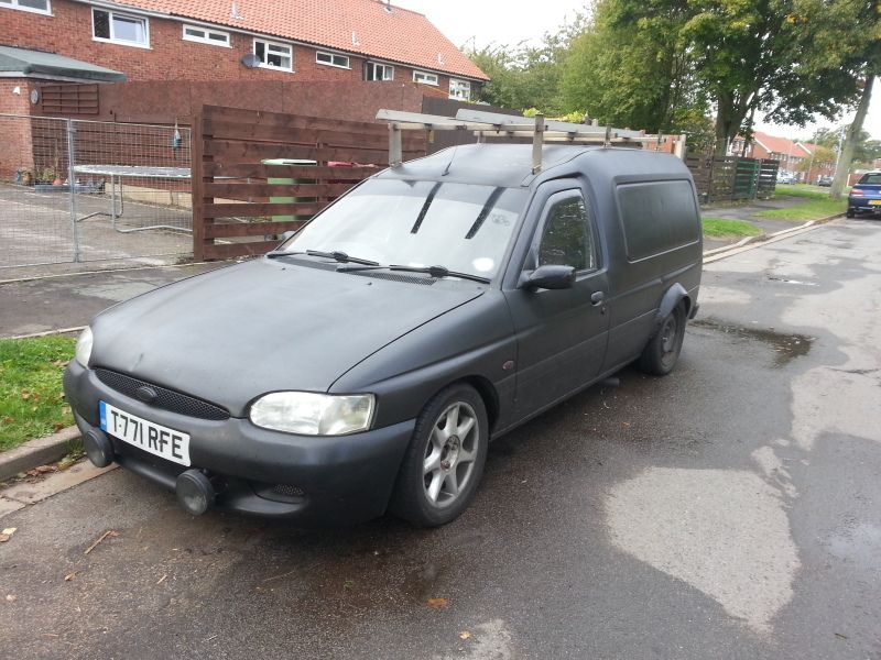

PostPosted: Tue Oct 02, 2012 3:52 pm

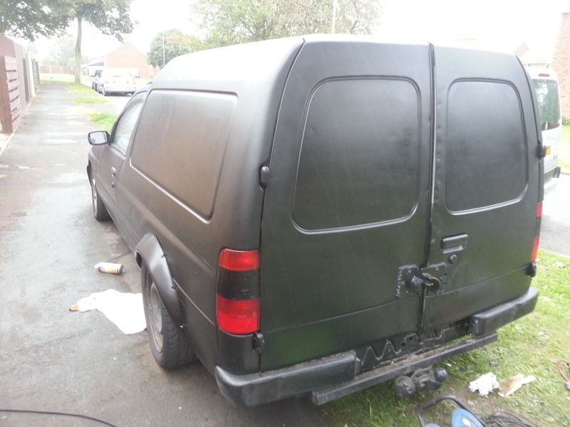

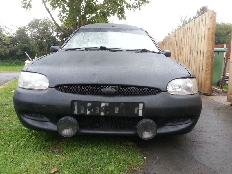

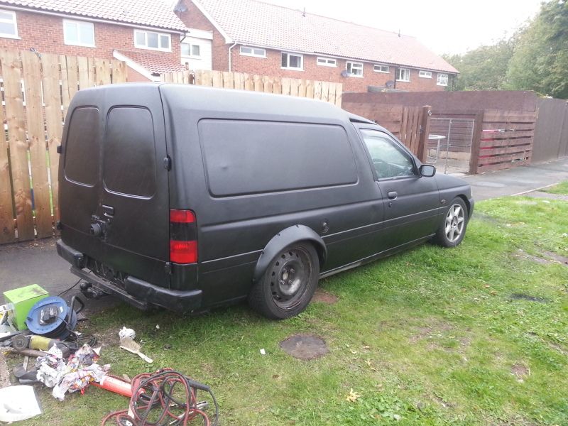

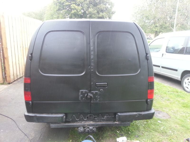

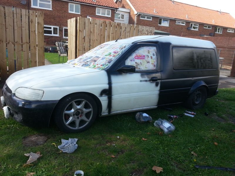

Reet.
Updates.
Painted satin black, still got the roof and bonnet to finish.
Got a roof rack, for no apparent reason.
The back of the van was my home for the weekend at a bike rally, and was awesome.
And the rear lock/handle is fucked, so have to use the mighty big lock I welded in, but that is proving to be a twat as the rear doors are bent. Oh well.
Got some new wishbones to make adjustable, will fit my other steelies and jdm arches on front once the wishbones tracking and camber are set up. Also toying with an idea of fitting better suspension to the front, and maybe a tad lower so it matches the rear.
Also need to adjust the exhaust, thinking of cutting into the sill and welding like an upside down U in the sill to the exhaust can sit at sill height and not be low, therefore not twatting everything physically possible.
Still need to fix my rad fan switch issue, and a few other little bits, but tbh I'm just keeping it running. Might fit a chargecooler to it, or just a bonnet vent like the old scrote.

PostPosted: Tue Oct 02, 2012 4:11 pm
That looks awesome!! :D
It will look much better when the front is complete with wheels and arches too. Cant wait! Mag feature after that I think :lol:
