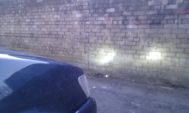

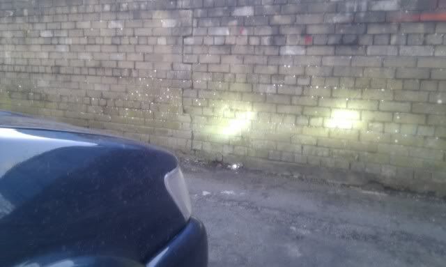

not the best pics will upload more from tonight, might need to align them better but ive done the best i can for in the daylight
 Post subject: Re: Petrol Blue 1.8 Si
PostPosted: Sat Feb 26, 2011 10:18 pm

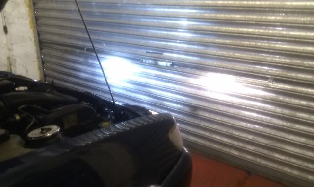

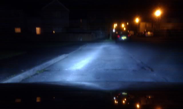

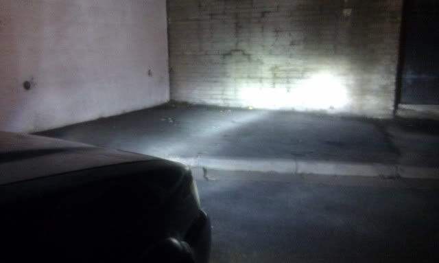

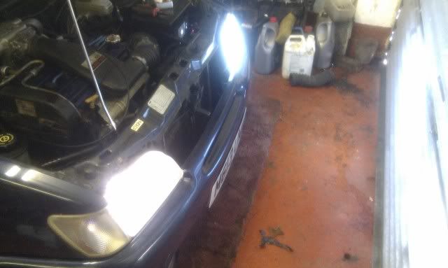

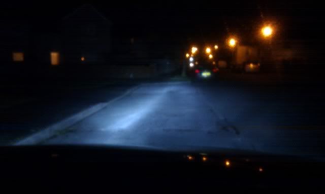

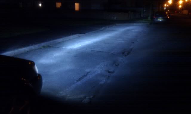

i need to alter the passengers bulb as its emiting a slanted pattern, and i could see it on the roof lining of cars infront, so i apologise lol

i have altered the passengers bulb its sitting much better now and aims just like the drivers, should be better, its a learning curve really

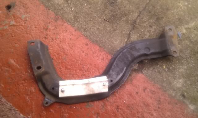

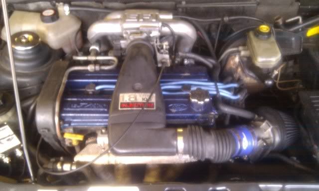

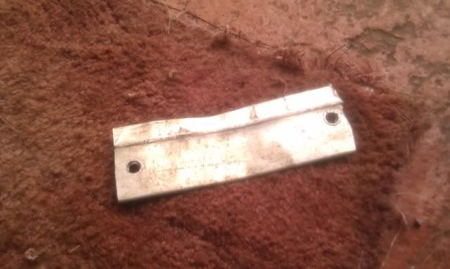

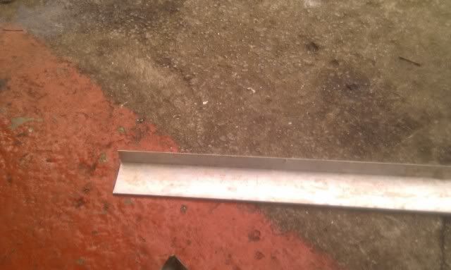

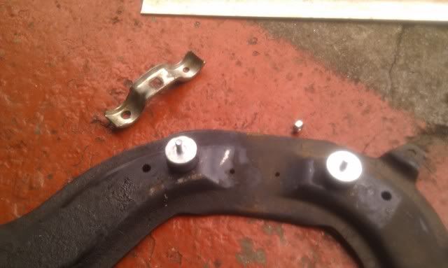

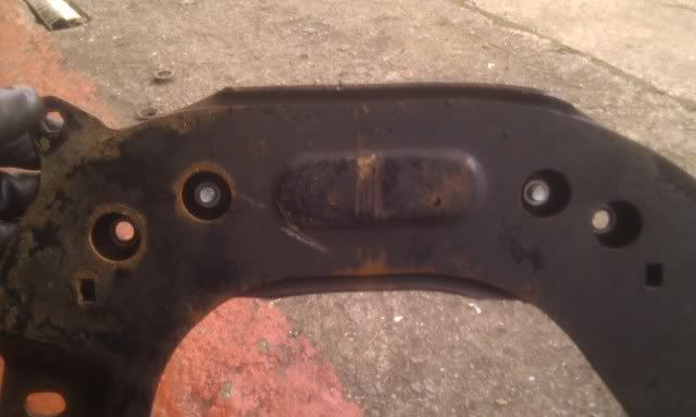

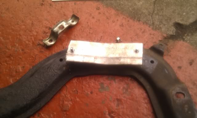

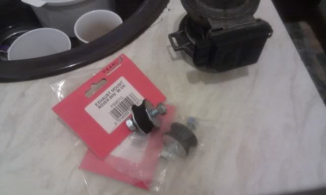

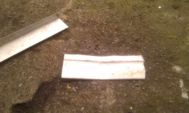

refitting my four branch, as most know these are built for escorts,a d the hanger design is missing for the strut brace in the Si, so it rubs and sends all the vibrations through to the car and done my sweet cherry pie in :rolleyes:
so i bought myself some early mini exhaust mounts and i was going to make my own hanger
normal cat/manifold off
using some L shaped aluminium bar
shaped slightly
Drilled
fitted
using the standard holes

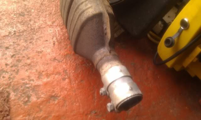

these are the exhaust clamps ive been using, theyre good apart from the fact they dont seal too good, you need to slap some sealer on the joins, but with the four branch one i aint going to, i know it will only come loose in time and the louder tone will be back so fuck it it aint that loud so it doesnt bother me, actually sounds nice
after some wrestling with the four branch its back on, trimmed the heat shield, this is on only to hold the crossover pipe
then went for a spin to test it :)
after fitting, then removing and once again fitting the four branch, its such a good enhancement, not just because it has some good solid power, its the fact that it frees everything up, the car feels so much better unrestricted and smooth, when ever i buy a zetec engined car i will make fitting one of these one of my first mods to the engine
brilliant

Good work on the fix for the exhaust.
PostPosted: Sun Feb 27, 2011 10:06 pm
cheers, if you have the tools and flat bar it only costs £2 at halfords for the exhaust mounts, with my discount i got them both for £1.39 :D

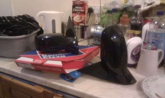

also my mirrors were finished too, will be fitting the pods onto my electric ones soon :)

looks great, love the mirrors
