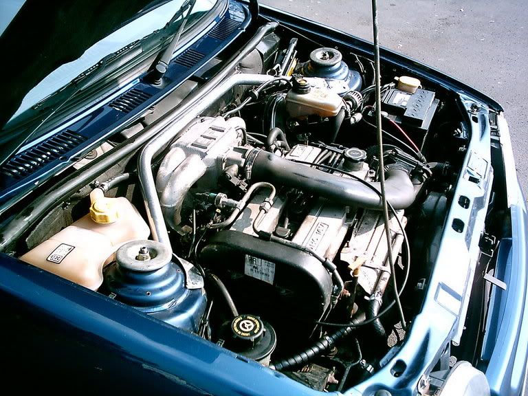

[size=18]I have purchased some omp strut braces for my SI but the problem is the front one will not fit over the inlet manifold it jus rubs on the side has anyone got any solutions to this ??????
Also is there any other smaller manifolds i could fit ???
Does the Rs 1800* inlet manifold fit into the si ????
i think i have bought the cvh strut braces so it is a bit diffrent ??
thanks simon
[/size]
simon aughton
PostPosted: Tue Jun 12, 2007 10:32 am
Yeah if you've bought the CVH one it wont fit, the RS1800 Inlet will fit on the Si, but its the same external size, its the ports that are different, so the brace woud still not fit.
PostPosted: Tue Jun 12, 2007 10:35 am
Yes, you have the wrong strut brace - been there and done that after being assured by the knobber in the shop it would fit.
You need the Zetec one so it clears the inlet manifold, as it has a different angle in order to clear it.
PostPosted: Tue Jun 12, 2007 10:40 am
Piccies:
The OMP strut brace for the cvh will foul the manifold, rub on it, and when you run the car will cause excessive vibration due to touching the manifold!
