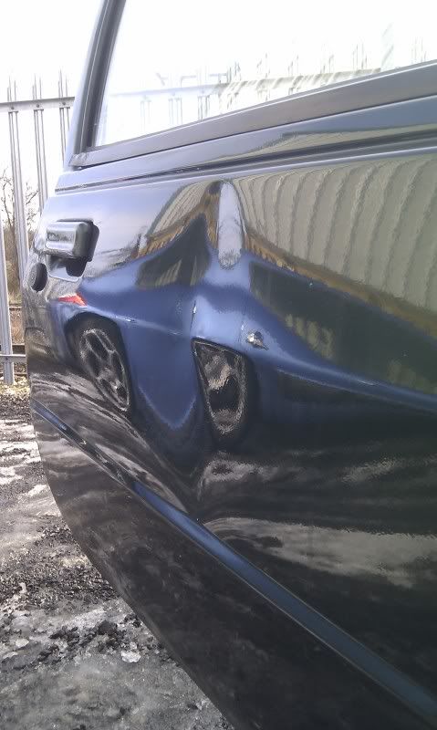

First job was to sort the drivers lock and also push the dent out. The car locks fine but doesn't want to unlock from the key and interior door handel. I lubed up the catch and all seems ok.
While the door card was off i pushed the dent out on the drivers door, most of it has gone so will do for now

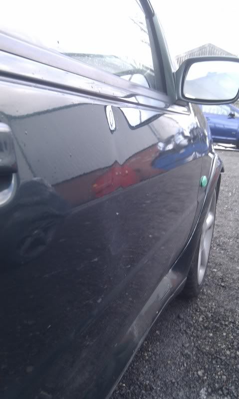

The biggest problem i've got with the car is the colour, doesn't appear to be a manufactures colour. So far i've checked all the chip at work, up to Kia, the search will resume tomorrow. I've also had the colour brick on it, its a small computer which takes really close up images of the paint and references it against all manufactures paints. It came back with Toyota dark green, checked the chips but its not close enough for me.
In two minds to respray the car or sell it on, the respray won't cost alot but is it worth the effort on a £500 car?

It is a bargain for £500 and the green is a nice shade, will be good if you can keep it that way. I find its regardleas what a car costs if your willing to work on it and get pleasure of of it.

I would have thought it was tourmallard too, but it does seem a little bit lighter. Is the arch kit darker than the rest of the car by any chance? It looks it, that is more tourmallard than the rest of the car.
I don't think you should re-spray it, not really worth it.

the colour is tourmaline green

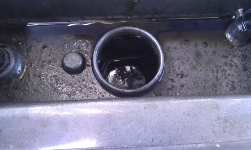

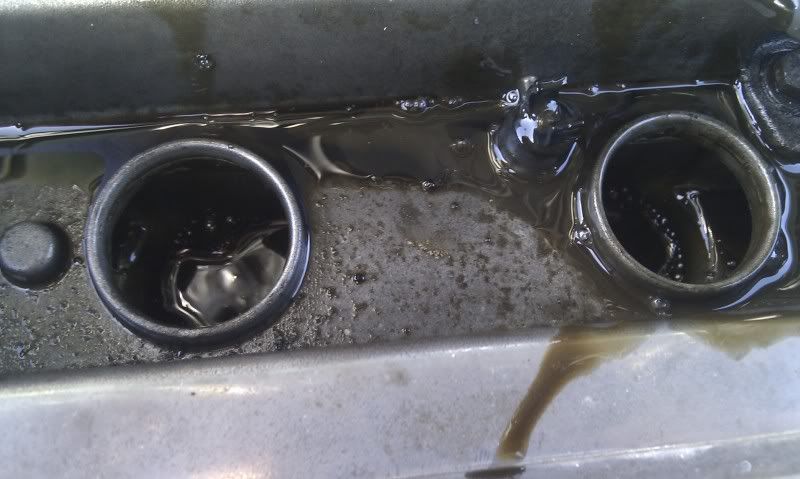

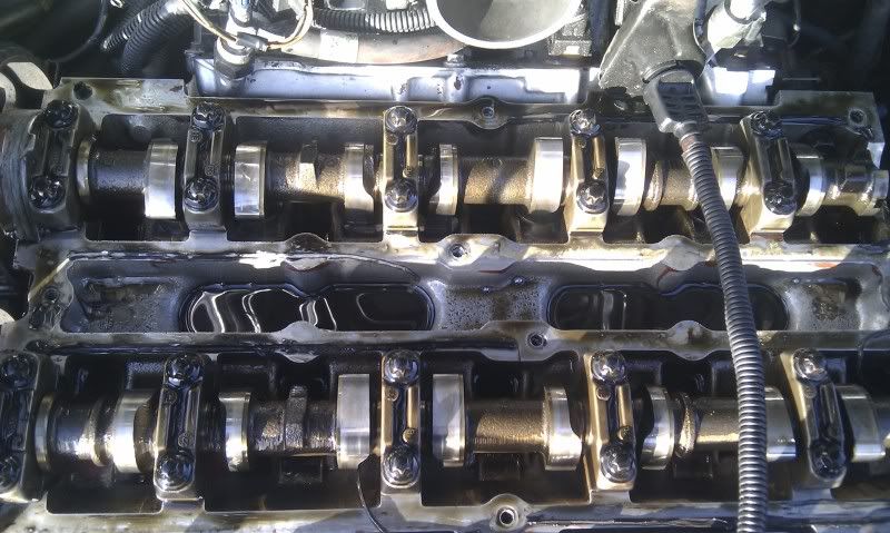

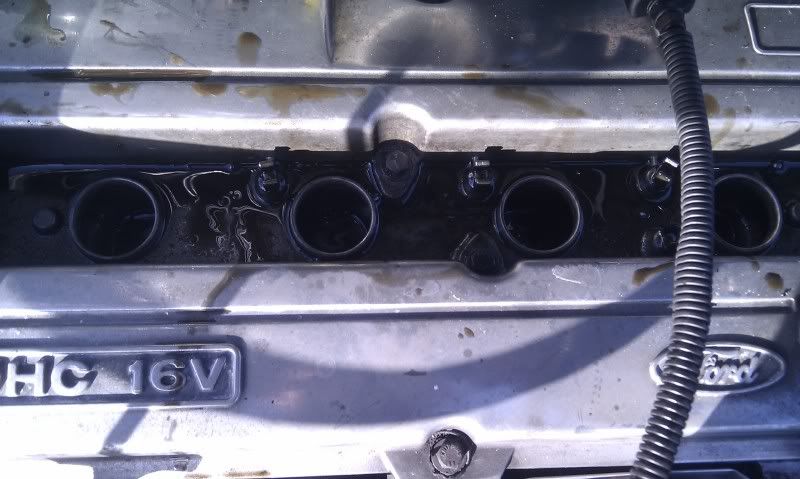

So today i had a look at the oil leak and replaced the ht leads with the new ones that came with the car. What i saw next i couldn't believe.
So pulled another and another......

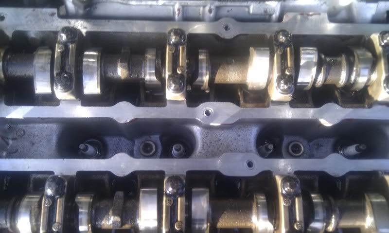

Pooed myself at that point, time to whip the cam cover off
Cam cover gasket was still intact but appears to have been bodged with sealant. Soaked it all up, removed sealant, replaced gasket and refitted it all.

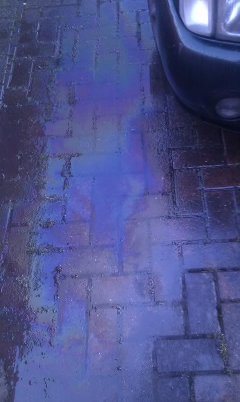

I covered the engine and bay in engine degreased, left for a while before jet washing off. Bloody oil patches all over the drive, the missed aint happy.
I've covered over 100 miles so far and no oil has seeped out of the cam cover, think there's a leak on the bux but that's for another day.
