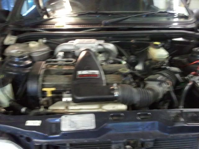

I've dropped the 2litre in wiv tb, maf and ecu so far.

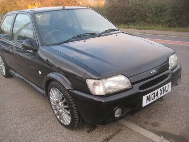

It looks just as i bought it apart from an rst bonnet ive just put on.

I'm quite happy wiv the outcome of the 2litre, especially the noise it makes...PORNOGRAPHY!!!

and for the looks i just recently saw a pic on here and this is what im aiming for
Accept someone informed me im not sitting low enough for this look, thought i was at 35mm but not sure now. but the xr2i bumpers, skirts and arches matte black, euro wheels and i want a dull orange body :D

60mm drop minimum if you want the above look.

60mm yea, the guy who had the car before me put monroe shocks n springs on so seems a shame to waste them, but then again i do love that look!
