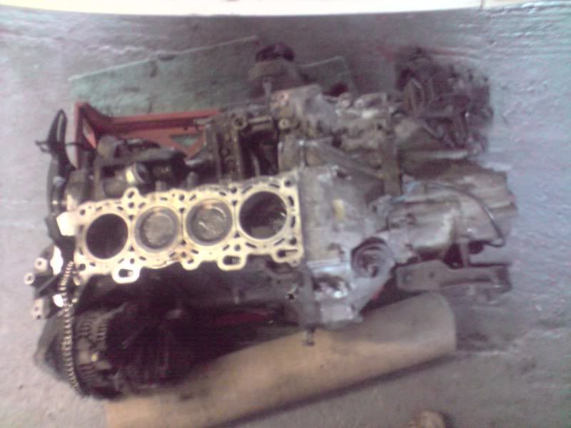

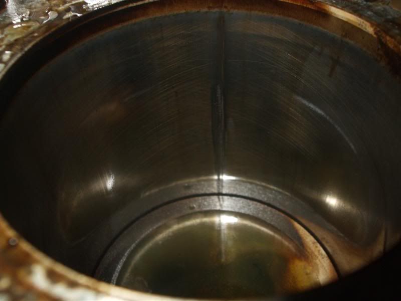

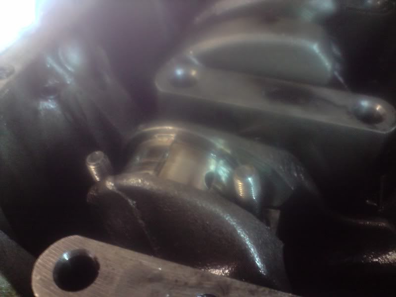

Basically, the big end bearings went on it and the bore was scored on one of the chambers. So it was time for a new block.
The inspection:

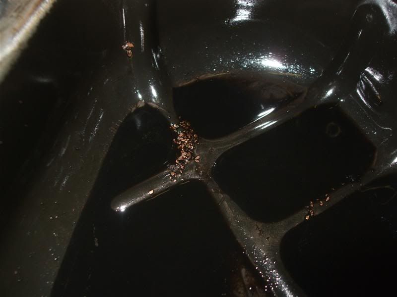

Off came the sumps to see what was going on at the bottom.
Well, that doesn't look too healthy does it...

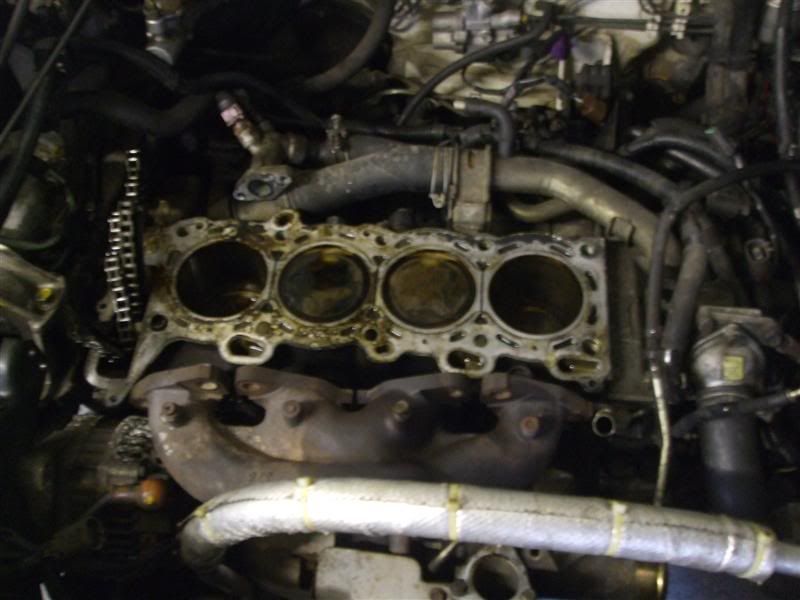

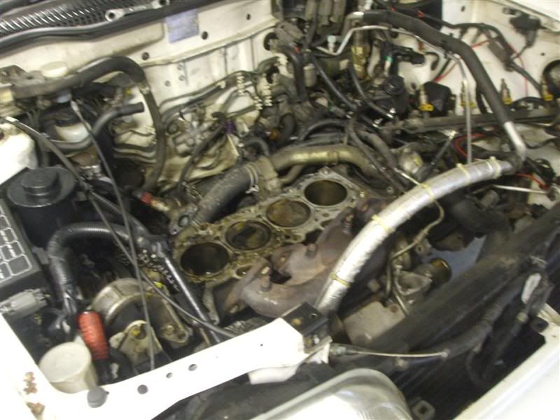

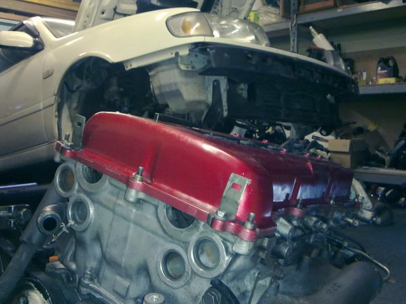

Time to get the head off...
Oh dear, there's the scoring...
Looks a bit worse for wear :(

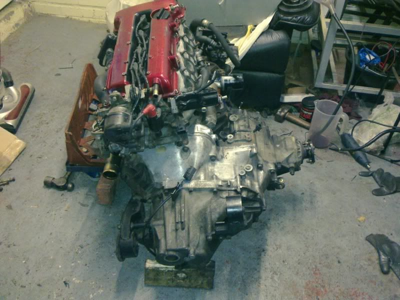

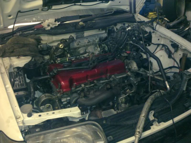

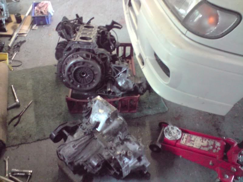

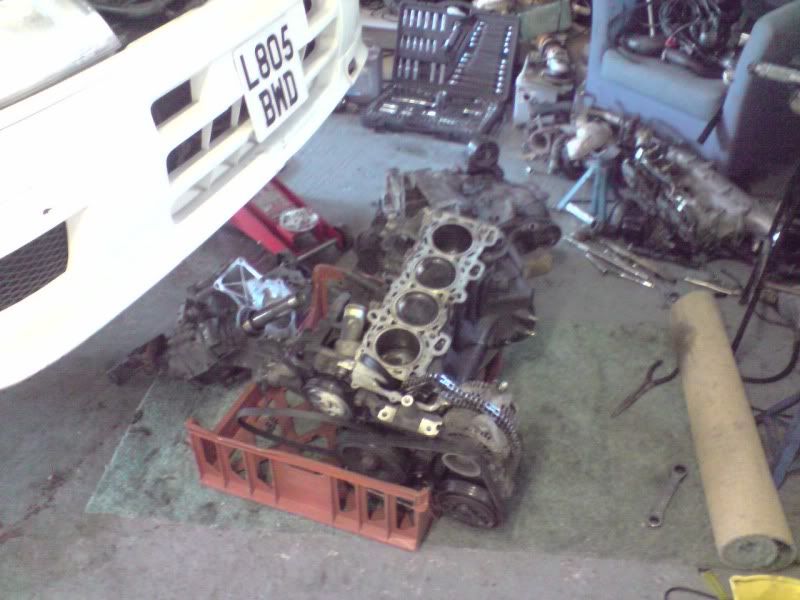

Well, obviously the engine now needs to come out and get rebuilt. Like I say, a new block was sourced, and a few parts needed. So out with the old...
Quite hefty with the gearbox and transferbox on...
Gearbox off...

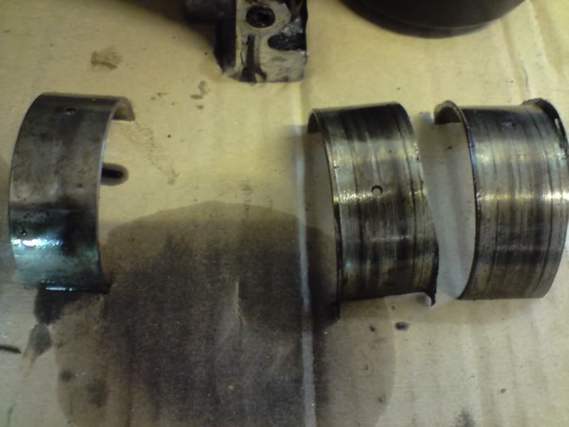

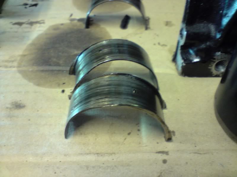

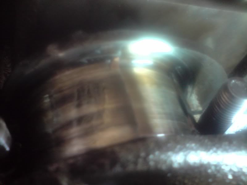

And now let's turn it upside down and have a better look at the crank with the piston end caps off...
That's not right :lol:
Some lovely crushed bearings...
One still intact on the left, 2 crushed ones on the right...
Diagnosis complete, time to go and get the parts needed :D

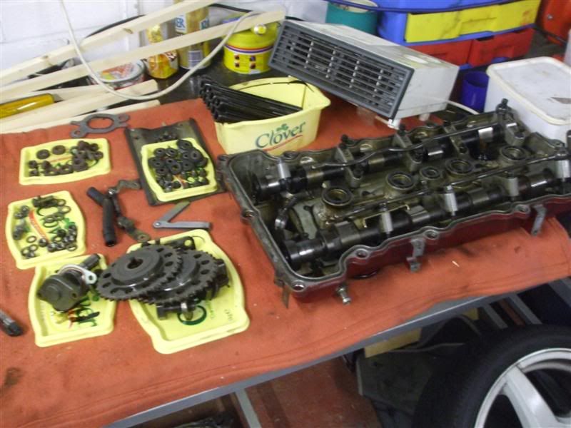

Well, after looking at my budget for the car, forged pistons were not an option. The standard internals can take up to 350bhp anyway, and I'm not going to be chasing any more than that just yet, so why bother spending so much on forgies when I couldn't really afford to? So I just uprated whatever else I could.

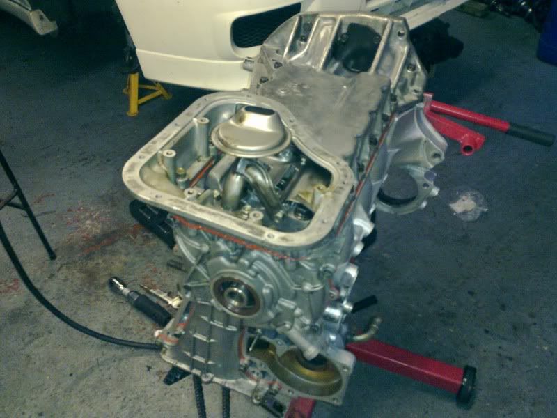

This included ACL race bearings, ACL main bearings, and ACL thrust washers, and multi-layered steel exhaust manifold gasket. Everything else was considered but as said, I only need standard items for the rest. So I got new gaskets, head gasket, oils, filters, chain tensioner, and the crank had to be reground as it had some slight scoring. The crank is hefty enough to take some grinding without weaking, so 0.25mm was shaved off and I got oversized bearings to match...

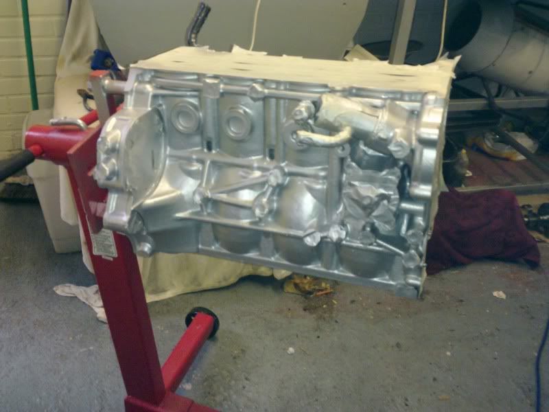

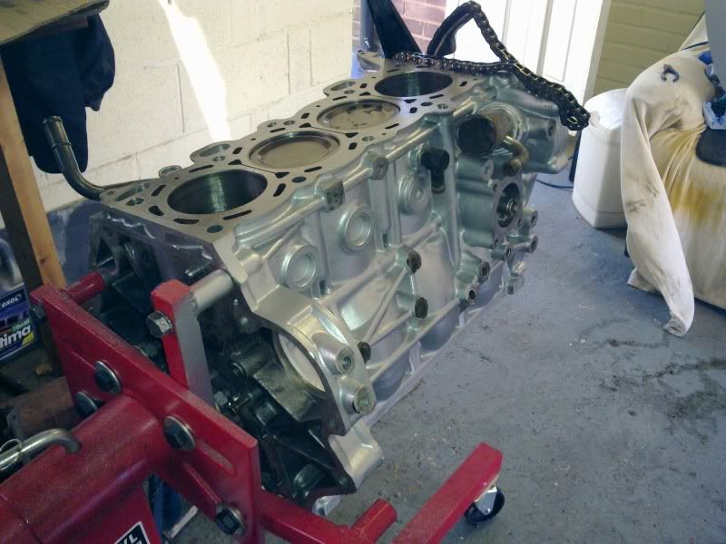

Now, the block I sourced was black. I don't like black, how you supposed to see oil leaks?? :lol: So a clean and repaint was needed...

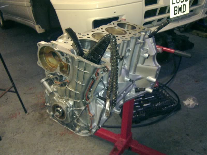

Then I got the crank and pistons in with all the new bearings...

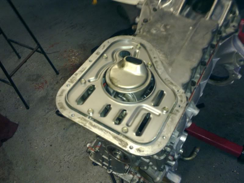

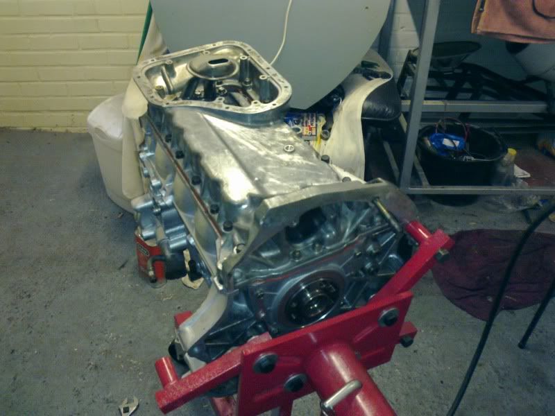

I cleaned up a few parts here and there, but I was losing patience with cleaning and just wanted to get the thing built so I just carried on with whatever I had... sumps on now...

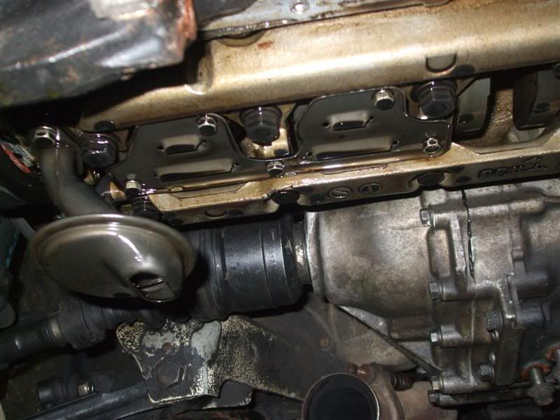

Oil strainer in...
Baffle plates on...
Mmmm, clean, and no metal shards in there now!

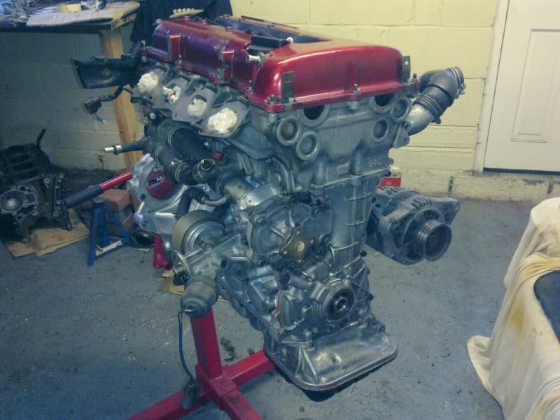

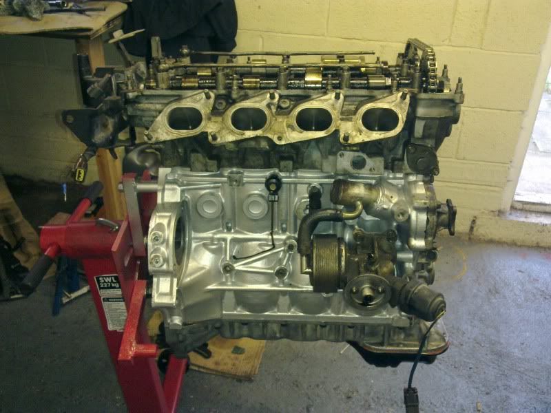

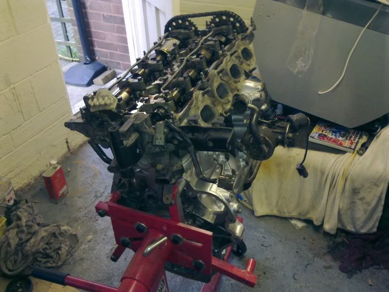

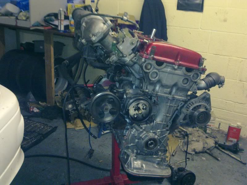

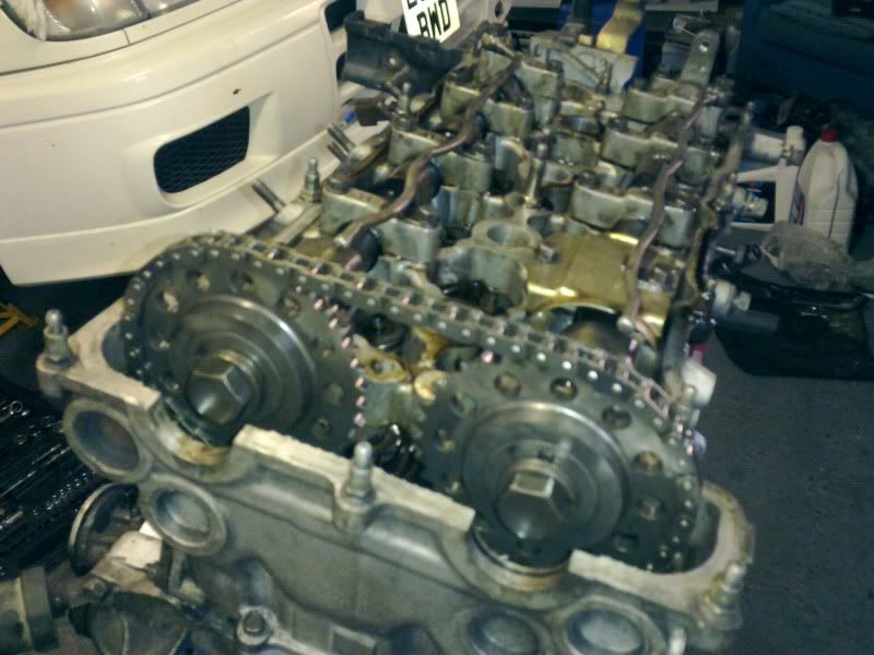

And then came the head. All went on, no pics of progress, just the end result...
Timing chain FTW...

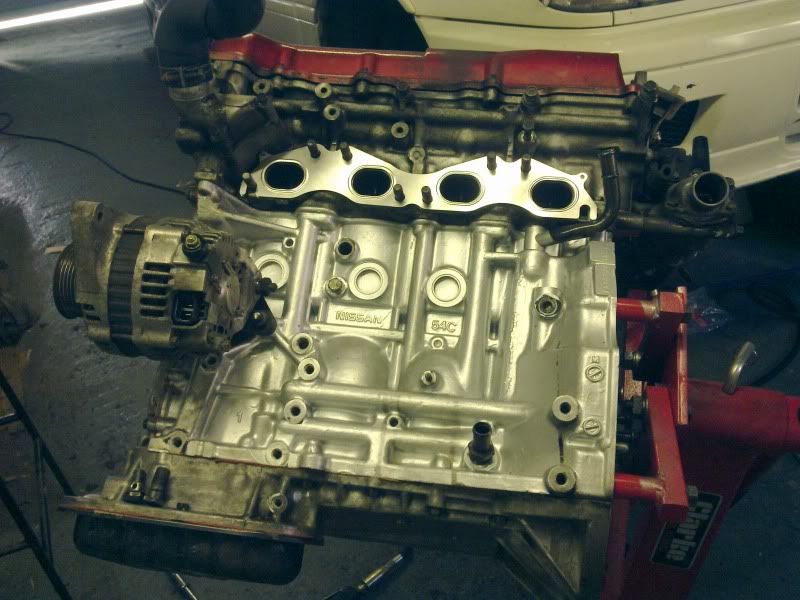

Starting to look like an engine again now...

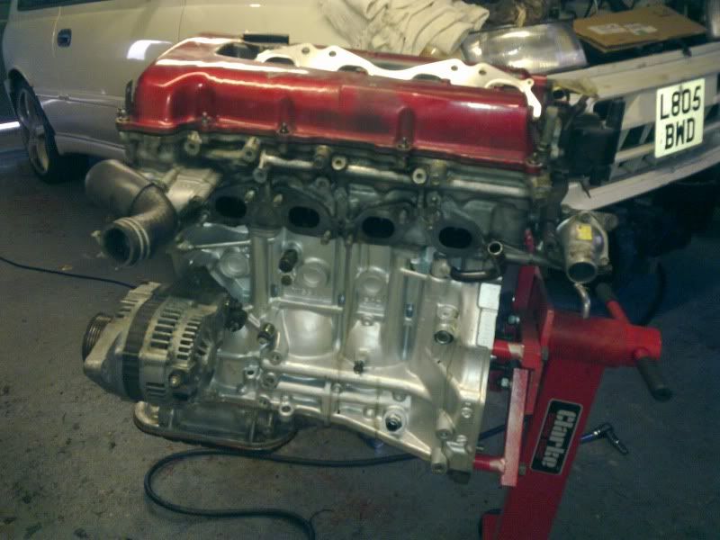

MLS gasket on...

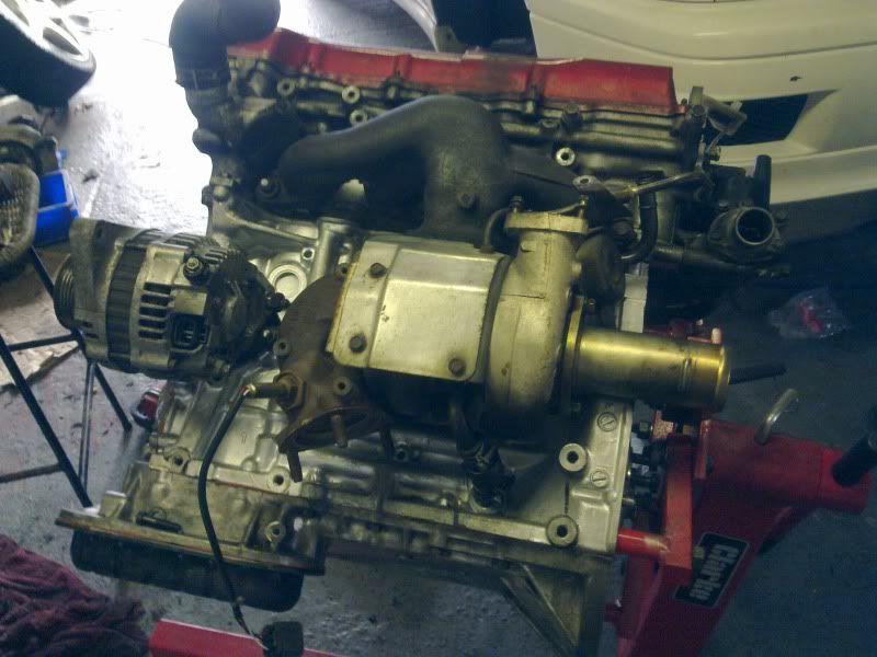

Turbo on...

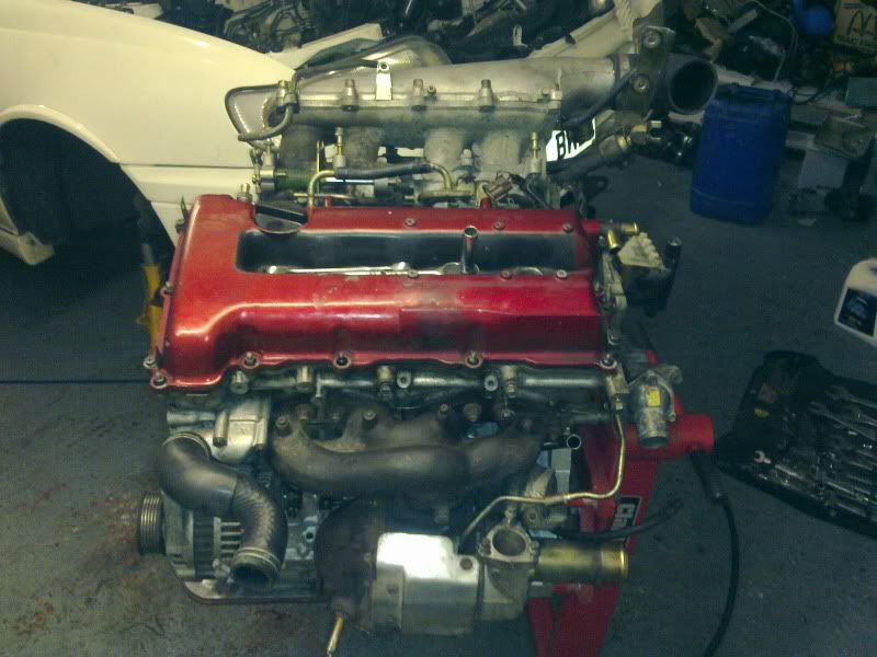

Inlet and most ancilliaries on...

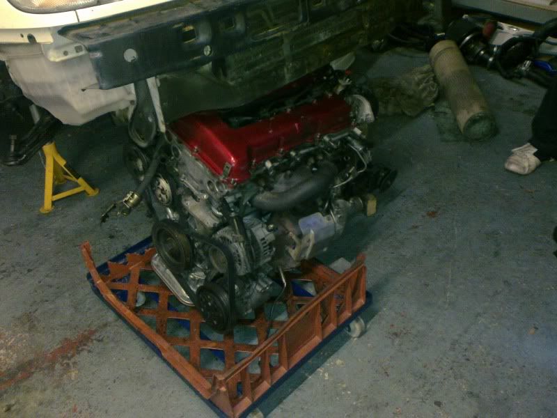

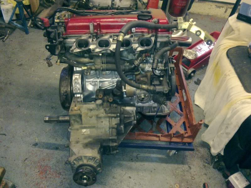

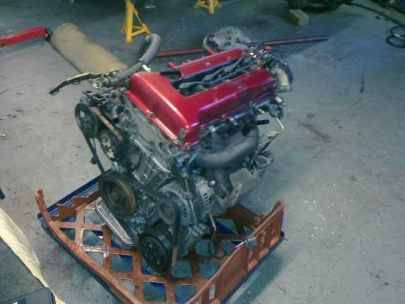

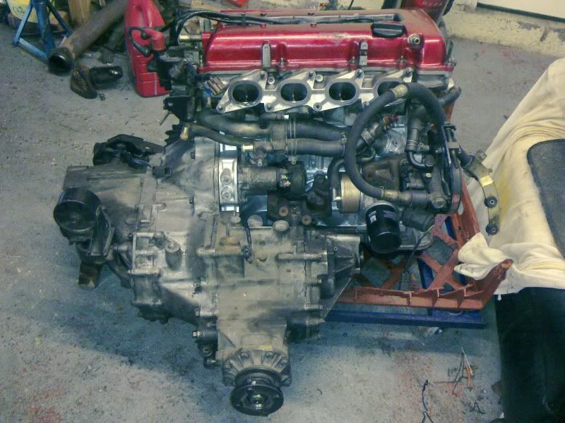

Then it had to come off the engine stand, onto the floor. I used a bread tray for manourvering the thing about, awesome bit of kit :D :lol:

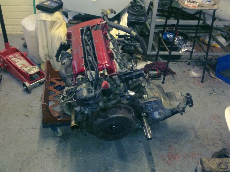

Transfer box back on...
And the gearbox...
You may have noticed I took the inlet back off. This was to allow the engine to slide under the car, ready for it to go in. I wouldn't have got the clearance with that on!

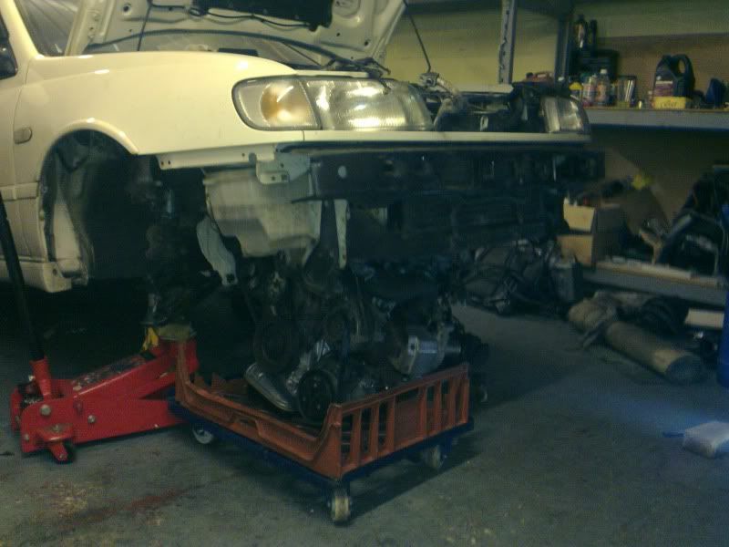

Wheeling it under...
Clearance was tight as you like :lol:

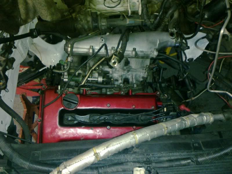

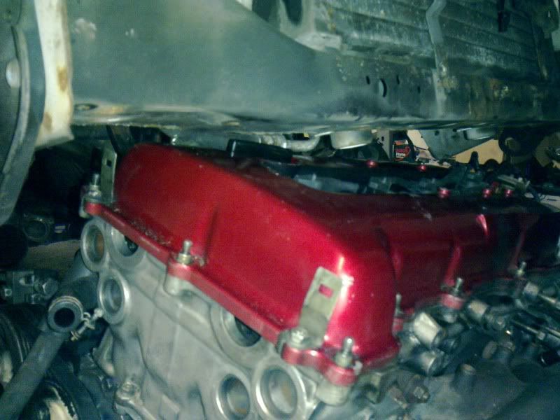

Then the inlet goes back on whilst it's under the car but before it's mouted up to make my life easier, and all the engine loom is plugged in...

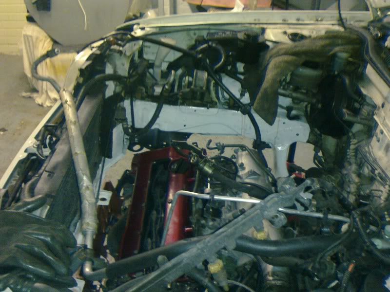

Not a lot of room to manouver...
But after a bit of faffing about to get the mounts lined up... she's in!

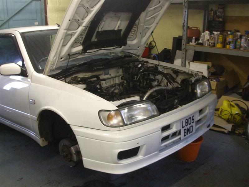

No current pics, but here's how she stood just before it went bang...
