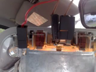

i need to know what to do with this tho,
i have a fez mk4/5 ghia light to put in with the extra map lights and im not sure what wires go where.. ive found a thread on ft but it doesnt explain what to do!!!!

as for your mk4 ghia light its easy to wire up, the 2 point plug with the brown wires going into it needs to be cut in half so there 2 seperate plugs and they go onto the 2 prongs next to each other in a sort of L shape then the red wire plugs onto the metal plate, ill get a pic for you
btw its a real pig to fit into the car though :lol: cutting the metal on the inner roof is a pig and getting it to fit perfect is annoying! ill get measurements of the size that i cut mine to so that it will make it easier for you :thumbsup: worthwile upgrade though, so much brighter and great when you passenger wants to read something at night!

cheers jamie, i worked it out in the end, ive ended up cutting away all the plastic on the light tho, cut a big hole in the metal and bent the rest of the lip up, cut away a load of the roof lining and had to stick it up with no nails, lol. just waiting for it to dry now so i can take the tape off!!
