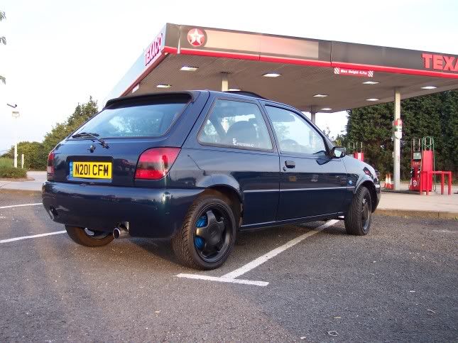

I was abit dissapointed wen i got em, there slightly narrower, 185/45/15, and cos there a lower profile, they look tiny in my arches, so in desperate need of lowering, other than that, its all gooood :)

Yeah drop it about 30-40mm... and I think some sideskirts would nicely finish off the car :)

Just happened to notice u have directional tyres on there m8 and the rear near side tyre is facing the wrong way !!!!
This will cause un even wear on the tyres and it may affect the way your car handles when braking !!!

Its facing the same way as the off-side rear tyre...

If its facing the same way as the offside rear tyre the wheels need swapping round on the rear,it should say on the side of the tyre "rotation" and an arrow pointing the direction the tyre needs to be goin !!!
