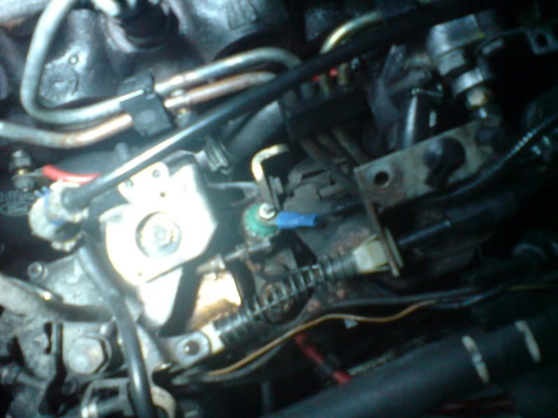

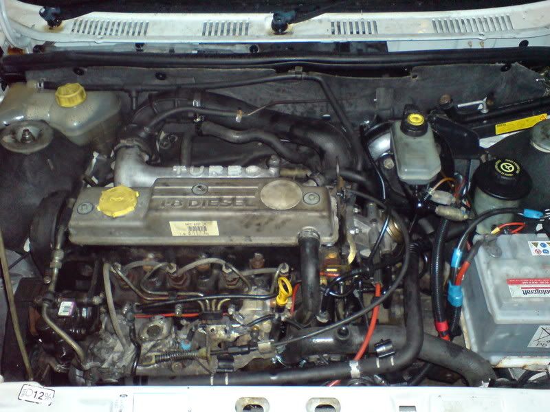

I put the battery on charge 2 nights ago for a few days as it was flat from me cranking it over 2 months ago trying to get it started :rolleyes: . I re-fitted the battery today with the intention of leaving it for my mate to look at, but I couldn't resist trying to fix it myself as I was pissed off with it not starting after spending so much time money and effort on it :cry: . A few tweaks with the throttle/coldstart adjustments saw no gain when cranking it over. My mates attention was drawn to the pump stop switch solinoid, there is a spade connection which goes to it (new connector and stop switch), I took it off and touched it on and off to try and create a spark, the spark was weak on the spade connector but strong on the bolt thread which the connector is bolted to. I unbolted the connector finding it to be all corroded and dull so I cleaned it up with some sandpaper and refitted. The big moment came and I got my mate to give it heat and crank it over, it fired up!! :D :D I missed the sound and feel of the Durv. I left it running for 40 mins to recharge the battery and dry the interior out that was probably starting to get damp. Fingers crossed it will start tomorrow morning when cold !
If it starts well over the next week or so I will get the RS bonnet painted for it :Q
A pic of the switch
