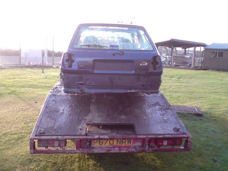

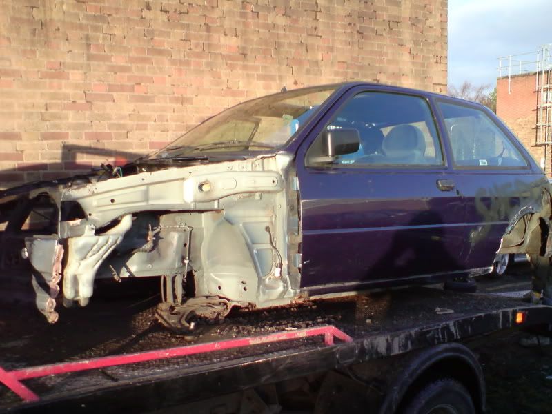

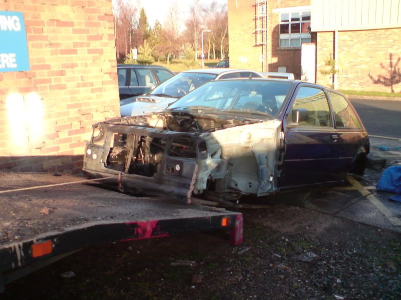

ell the rs is now gone to the scrap yard but it did put up a fight as the guy tried to get it onto the flat bed
and there it goes to the big scrap yard in the sky

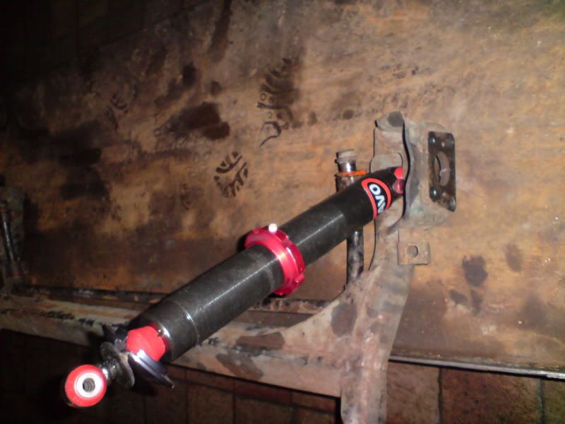

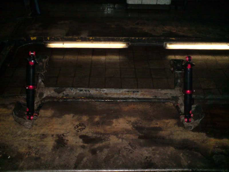

also today i started to build up the rear beam so i can just swap the si one over with the rs one
as i was taking off the anti roll bar one of the brackets broke but luckely ive got a spare arb at home
all beign well i will get it fitted tomorrow along with the front suspension

RS looks in a bit of a sorry state now! lol! I love the fact that it says "SHED" on the rear quarter pannel! Best mod ever :thumbsup: :lol:
