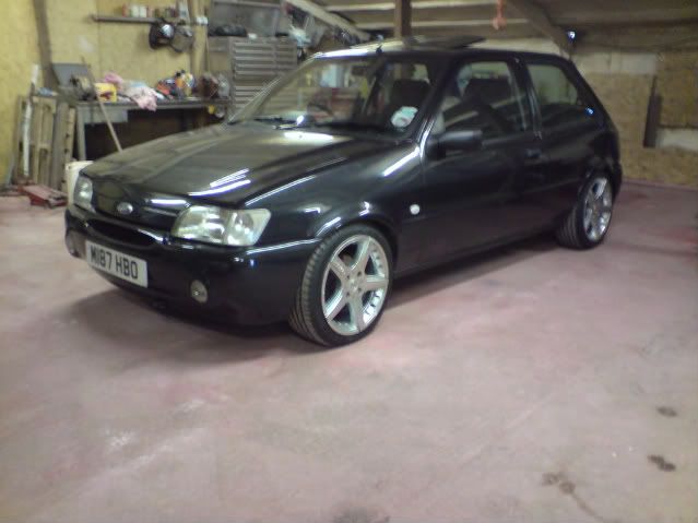

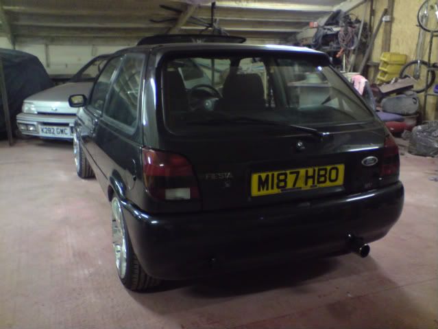

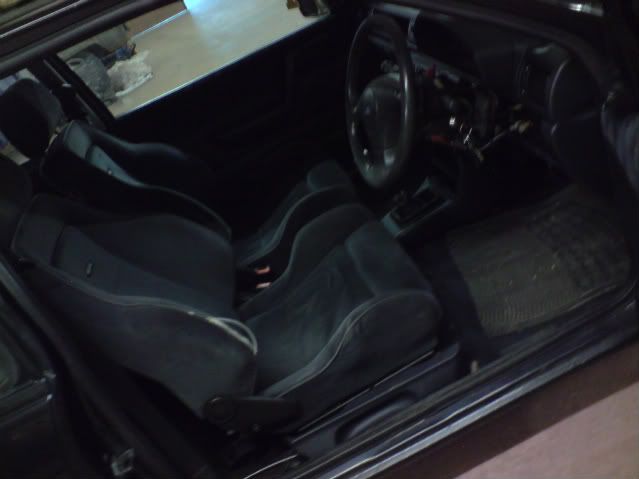

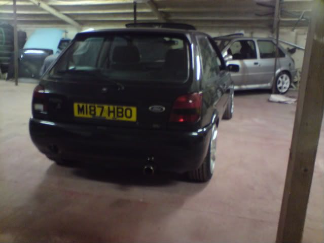

I picked this little beauty up for the missus fiesta si with the 2.0 zetec in the front of it still running the 1.6 box i think, it's lowered with Spax on a set of 16" Momo's, a S/S boxback, inside theres fiesta turbo seats but not the door panels the piping on the drivers seat is starting to rip as you can see the rest is standard, the body isn't to bad a few dents about but nothing major at all theres a set of the front si arch covers been fitted to the rear arches as well..

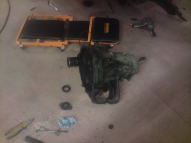

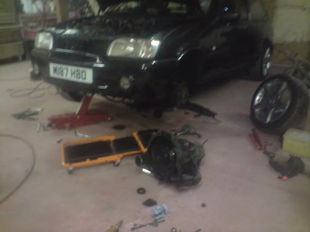

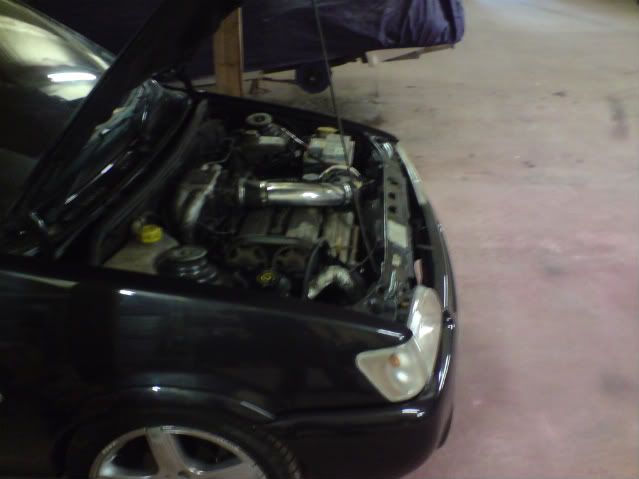

I pick it up on monday night with a knackered clutch it came with a new clutch kit ect. So tuesday after work i decided to take a look at it.. Half the gearbox to engine bolts where missing and the other half where loose and a gap of bit 8mm between the engine and box. :o :o :o
Whipped the box out cleaned it all up find the relese bearing had fallen apart and also the bearing locating pin on the operating shaft had snapped so i machined up a new one.. All back together witht he new clutch kit and working fine but i then realised the PAS rack has been remove and a standard one fitted.. :rolleyes: :-?
The bearing... :P :P

Like i said i bought this for the missus, but as she has no legs the Frst seats don't go forward enough so i've swapped them for my 2i seats, so the SI now has 2i wing back front seats, but it was the mk3.5 runner that are different and stop the seats moving forward so had to make some slight mod's to the runners so tis all sorted and the legless missus can now drive it... Once the log book turns up... 8-)
