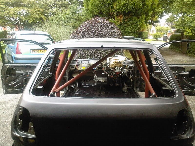

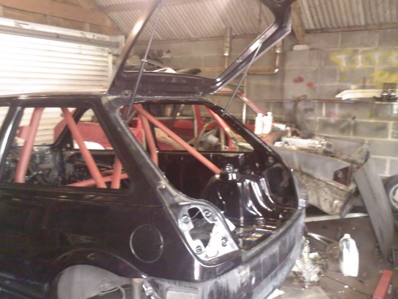

Just thought id post up some pics of my latest Si project
all opinions welcomed
**Edited**
As i picked her up off Ebay (many parts for sale, morettes sold)

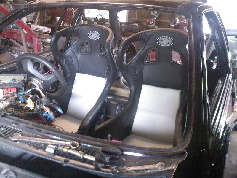

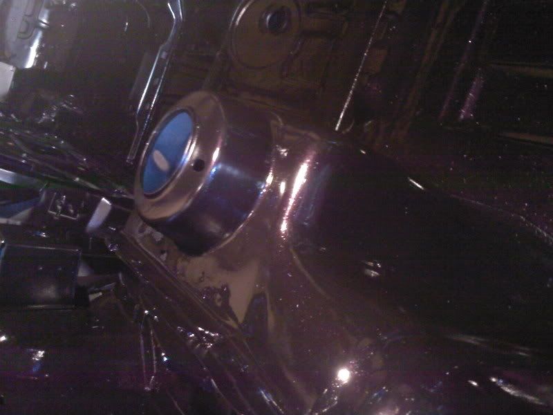

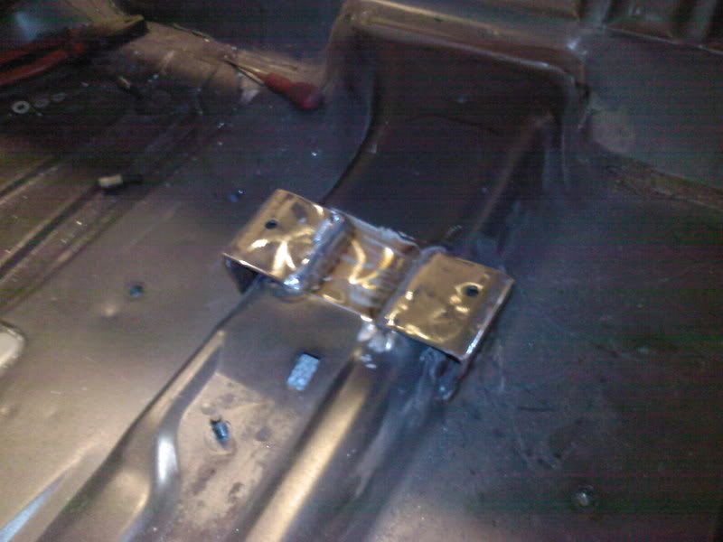

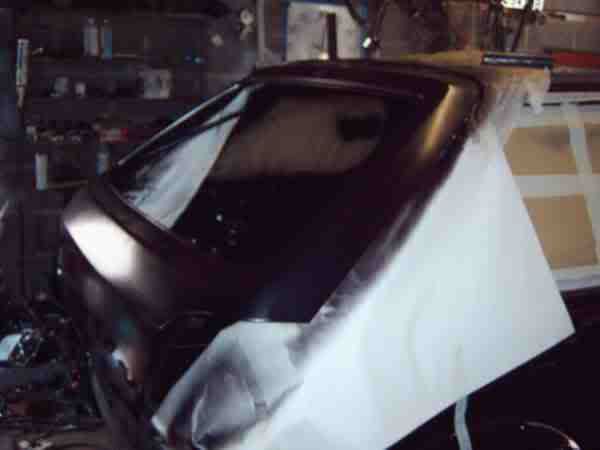

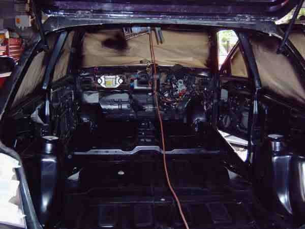

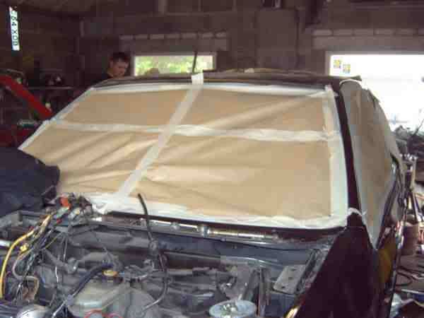

as i intend a stripped interior, all was removed from the interior and then remembered Fords cost cutting way of painting an interior so i decided to paint the whole interior, including roof.
before painting the seat mounts for my bucket seats were welded in
and buckets trial fitted
seats were then removed and the interior masked up and painted
resulting in a not perfect but pretty good finish

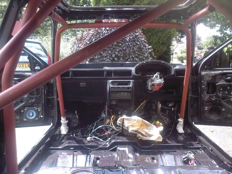

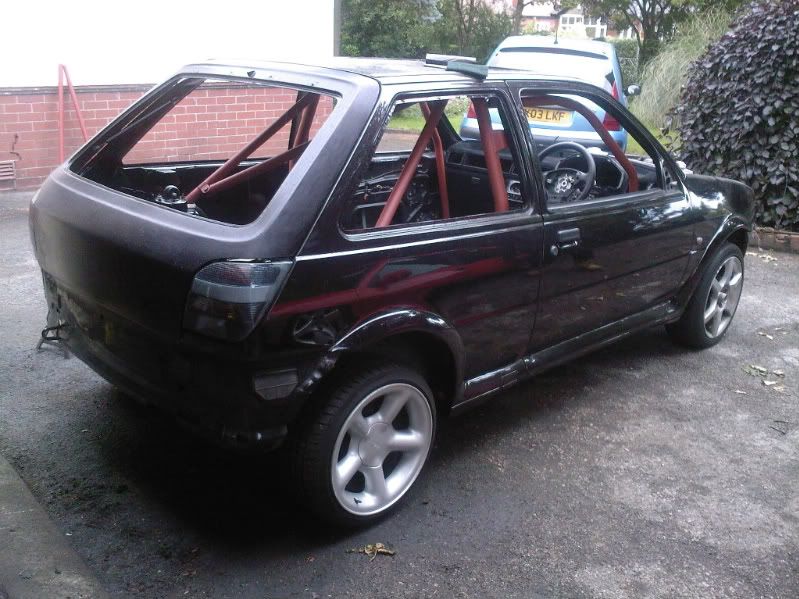

then the rollcage trial fitted, has yet to be powdercoated
i wont post a spec list atm, but if anyone whats one just ask

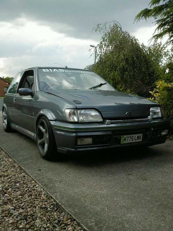

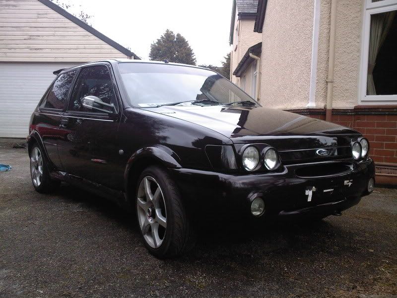

also one quick pic of my current run-around, can you spot a link between the two? lol :lol:

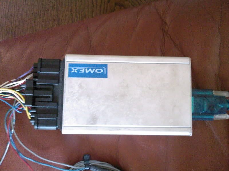

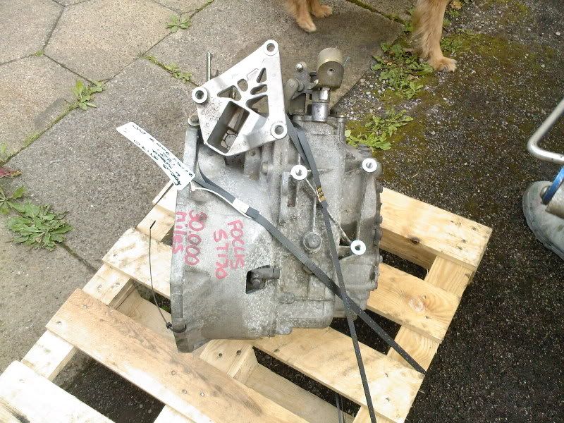

update -
omex 600 ecu ordered
ST170 Getrag 6-speed gearbox ordered
Carbon fibre RST bonnet ordered

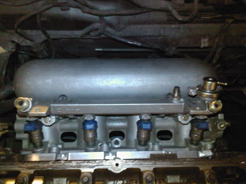

Mountune WRC inlet manifold bought and collected

welcome to fsi andy :D
what happened to the RS? is that the engine that was in the RS?
looks pretty serious with the cage :devil: :chill:

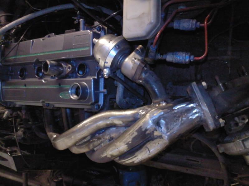

ah the tin worm,the bane of car enthusiasts lives :cry:

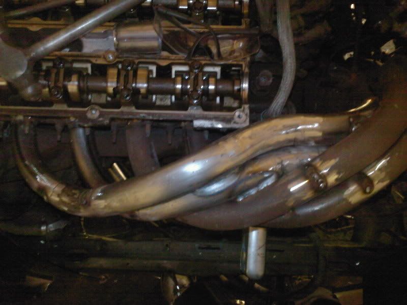

looks like this is going to be a beast tho :devil: , she aimed mainly at track day's or everydayness?
that exhaust manifold looks funcky :D

is that an OMP 10-point cage?
 Post subject: Re: My new Si project
PostPosted: Tue Jul 01, 2008 11:50 pm
Joined: Mon Jun 23, 2008 8:22 pm
Posts: 22
Si-2000 - yes its an OMP 10-point, but it has yet to have some additions, bit of a bargain really, brand new, never fitted primered cage £152 off the bay

you like cossie wheels alot dont you :teehheee:

I have to admit i may have a small thing about cossie wheels on fiestas, shame i only have one set!

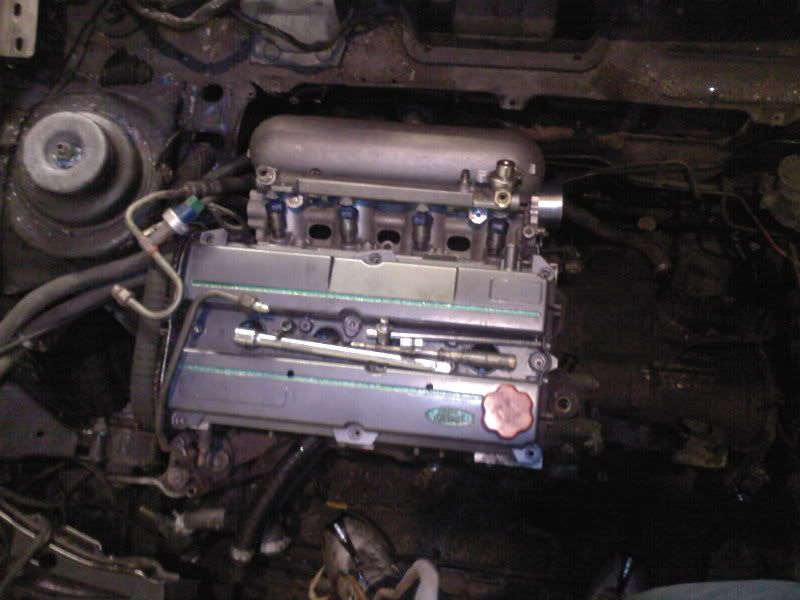

omex 600 purchased
ST170 Gearbox delivered ( woo hoo 6-speed )
Hyundai Accent WRC inlet modified and trial fitted

that exhaust manifold is gorgeous. good luck for the project, so many seem to be comming to an abrupt end(including mine....for now ;) )

24/07/2008
Lowsi- cheers im rather partial to it myself.
i'll be seeing this project through to the end as it is replacing my current car and is being build to the spec my old aubergine Si would have met if it hadn't been written off. the bodywork is going to be identical coz i loved how it looked but with a proper engine as i only had a cammed 2.0 with tubular manifold last time.
today was a fun day, drove home after work, arrived 5.30. removed the ofab ecu took the omex and modified my loom to fit with my mate, got it running on the omex and mapped it to 10psi, so i can use it to go to work tomorrow, then went back to my flat all done by 8.30.

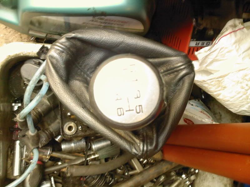

just quickly took a few pics of my new gearbox and gearlever (30,000 mile box!)

more playing with the omex today, it already had sensor calibrations on it when i picked it up so those were used for ease when we first connected it up, checked them out today and the ecu was reading 40 degrees when the car was 90! re-calibrated the sensor values for all sensors after this.
also had a bit more of a play with the map and ran out of injectors! lol
scoured round the parts store, *read - garage full of 'bits of metal' as girlfriend calls them!* found some of my brother's old rover injectors, checked the part numbers and found them to be around 1 1/2 times the flow rate of my beiges. these are being fitted tomorrow and we'll see how she goes
more fun today! fitted said rover injectors and re-set flow rate in ecu and changed map to suit, with me driving and my mate Graeme in the passenger seat watching the LM-1 wideband lambda reader and laptop on-knee adjusting the fuel and spark tables. got it fuelling right at 16psi, which is where it peaks at the moment. so we are back dealing with 4th gear wheelspin, always fun.
wired the now redundant ABS light to become a shift light at 6000rpm which is quite cool and went down the motorway at 60/70/80 mph respectively and set the fuelling to 14.7:1, so i can have maximum fuel economy when on longer journeys.

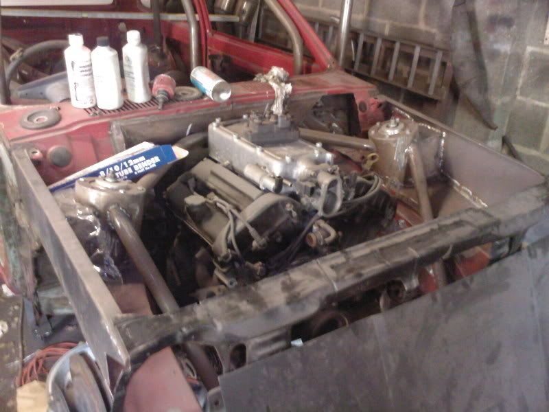

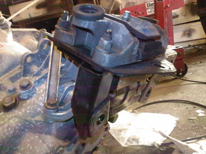

well, managed a bit today. got up early and off to the scrapyard in search of a focus gearbox mount, no luck. but did find a mondeo mount, which i didnt know but also fits the gearbox and even easier is that it simply bolts into the mondeo bay as opposed to the focus which would have to be cut from the shell. bonus!

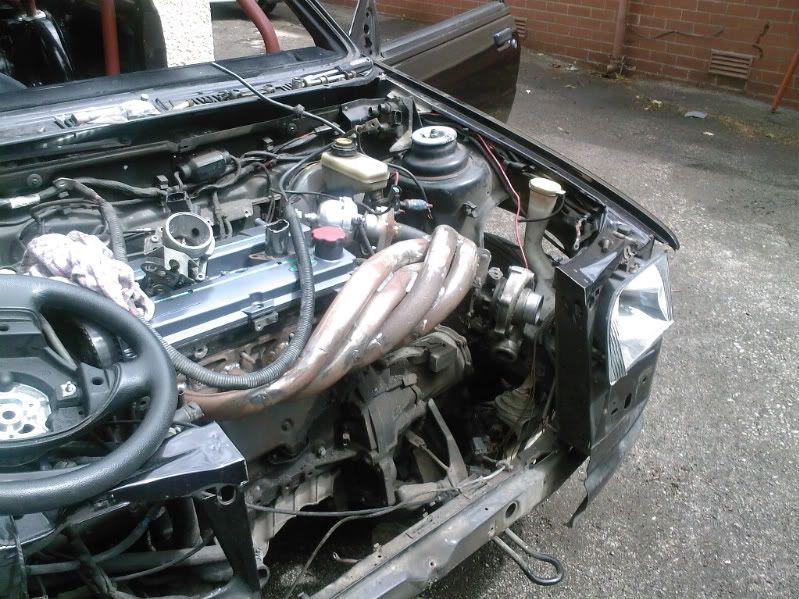

continued the stripping taking all the mock-up parts back out, and removing the air-bag control unit and bracket and all sound deadening from behind the heater. steering column and pedal box were also removed
the engine bay was stripped ready for the engine to be swapped over stripped so that only the engine and gearbox were left. at this stage the inlet was fitted to check for possible solutions to not being able to fit the gearbox with the brake servo. so to see if various master cylinders would fit under the inlet.
also finally got round to making a template to send to mike @performance trim for my bonnet.

How do you find the Raceland Seats, any problems with it hitting the gearstick? In my Rallye the sides of the seats fouled reverse! :doh:
PostPosted: Mon Aug 11, 2008 6:57 pm
Posts: 22
i dont know how the seats will be with the st170 shifter but they were fine with the standard quikshifter
