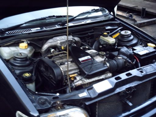

few pics of my car
hope you like the pics
any comments would be great
PostPosted: Mon Mar 21, 2005 8:00 pm
Joined: Sun Mar 06, 2005 7:34 pm
Posts: 126
Location: Liverpool
looks sweet mate!!
do it all yourself?
how much you get the engine for and whats the power like?

would you say it's a worthwile conversion to do? what exhaust you using?

the conversion is well worth doin
i use the fiesta front pipe and cat
and the from the cat its a powerflow
system
give me with any questions :wink:

ford scapers but he owed me favour

added you to msn mate
got my 2.0 today and wouldnt mind asking you a few questions about the conversion

take the cam cover off and in the opposite end of the cam there are slice's the tool sits in both of the slices to keep the cams timed up
and the crank pully has 2 notch's in the second one lines up with a triangle piece on the sump.
i used a mondeo engine with the plastic inlet manifold

but what happens if the crank pully has been taken off the crank? does the pully only fit on the crankshaft if its correctly positioned??? i understand the camsetting now though thank you, all i need to do is buy a tool!

thanks for that! i had a look today and had a mess about with all the parts its like giant mecano!
