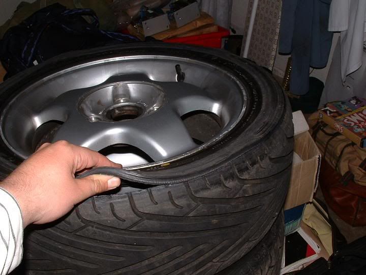

However, the car was too low and on my way to a show in May 2003 this happened!
I reset the suspension slightly higher and sorted the front arches out so that it wouldn't happen again!

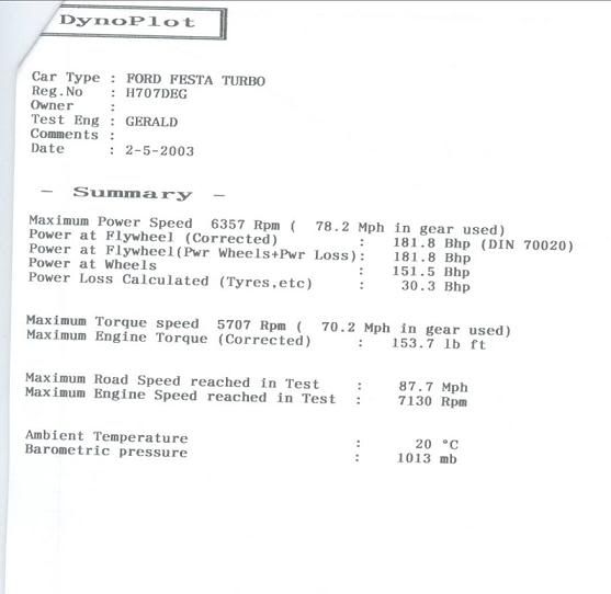

I decided to take the car to get rolling roaded pretty much as it was when I bought it despite a service and got the following results :)
That was pretty impressive for the relatively standard spec. the car was running so I decided to stick some bigger brakes on the car, going for Cossie 4x4 280mm discs and calipers up front (thanks to Gadget) and RS2000 mk5/6 rear disc setup (just about perfect for the Fiesta IMO).

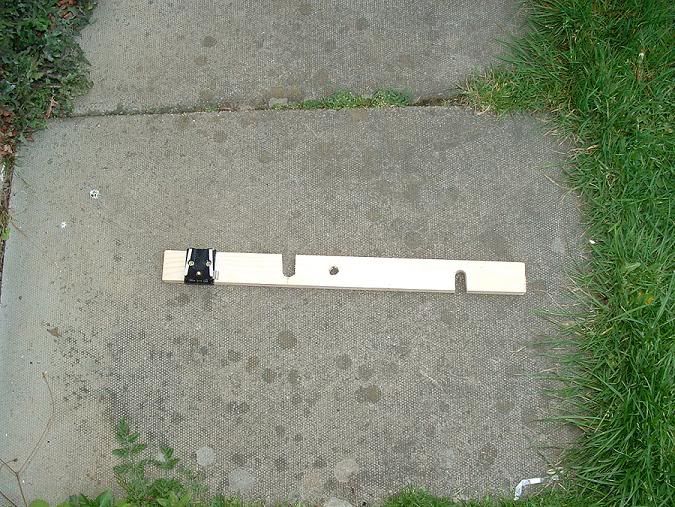

The camera I'm using for the vids is a Sony DCR-TRV19E on a wooden mount that I made myself which is now universal for normal Ford seats and Recaro's (the headrests don't come out so had to make slots!).
Here's the mount as it is - will get it painted matt black and smoothed off to finish it off :)
