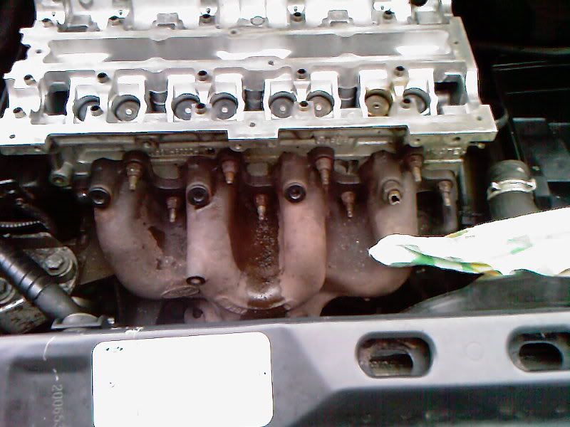

started on the 21st of Decemeber we got the old head off (inlet, exhaust, thermo, dizzy, belts) all removed in day one to the block

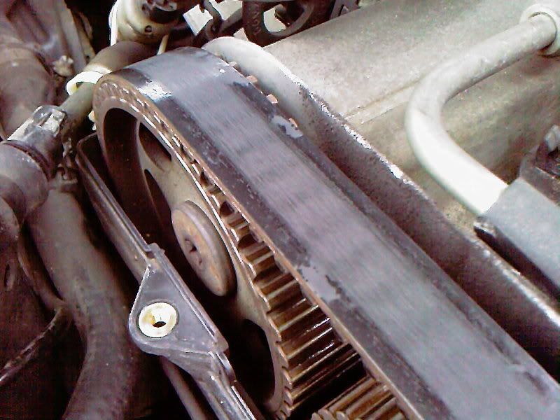

state of the old cambelt
good that i changed it when i did!

the EGR proved to be a MOFO to remove, they all popped out nicely but one which threaded inside the manifold, it wouldn't come out so i stuck a bolt in it :| took everything off the EGR including the cannister leaving a plug loose (taped), is this the right thing to do? or should i reattach the cannister?

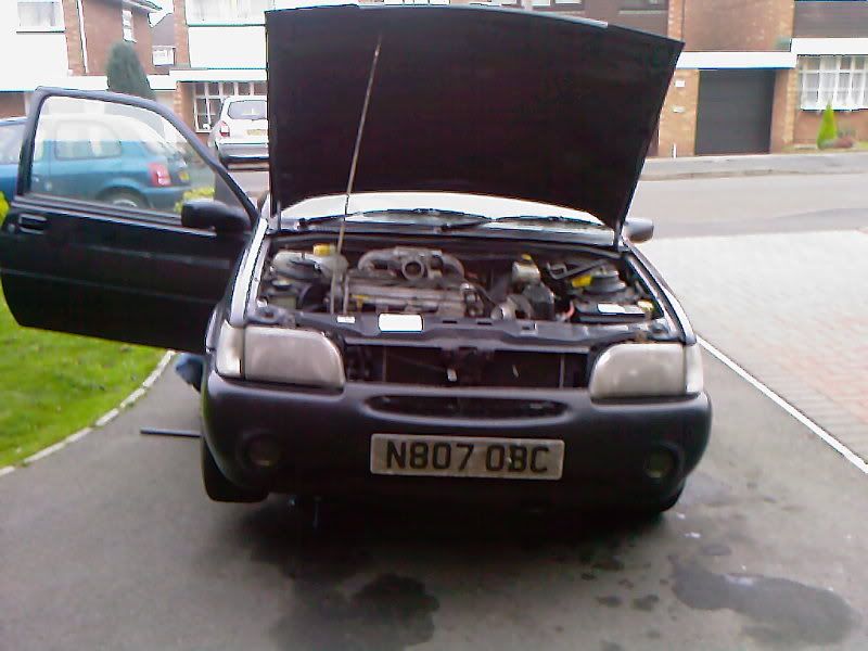

resuming action yesterday (28th) we got waterpump swapped over timing all done and inlet/outlet all ready for todays testing.
unfortunately it didn't work, we had low compression in Cyl.4, we feared the worse bent valves, but were v.luckly to learn it was sticky valves and a couple of manuel turns of the engine sorted it out 8-)
now it's all back togeather, no pics unfortunately
still have the water leak, but im sure its the T-piece hose at the bottom of the rad, other than that i've not tested the head too much yet
