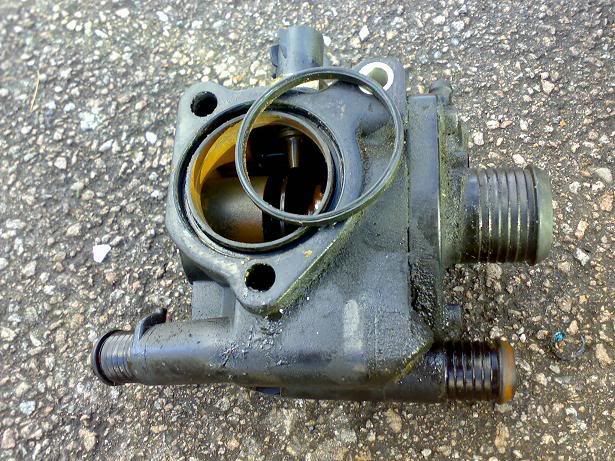

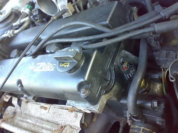

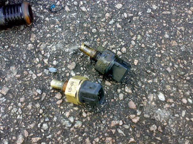

Had a coolant leak from the seal around the thermostat so had
to get that sorted, also put a different temp senser in as the gauge
was tempremental....
All back together

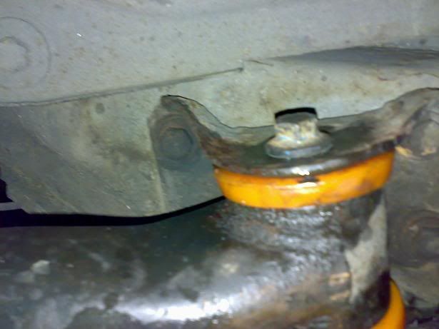

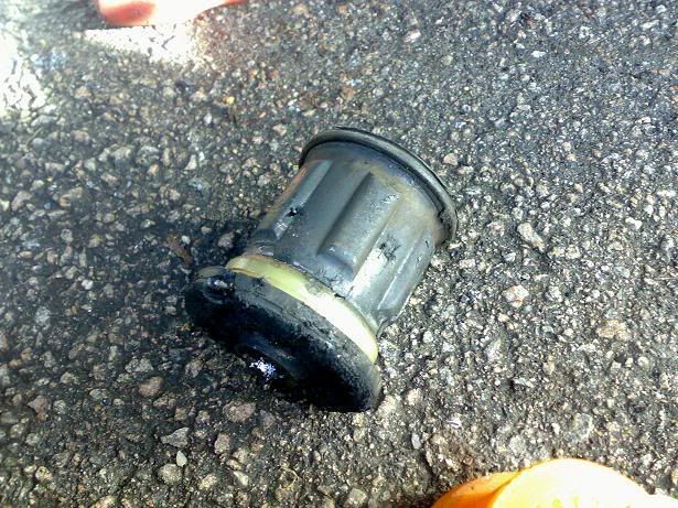

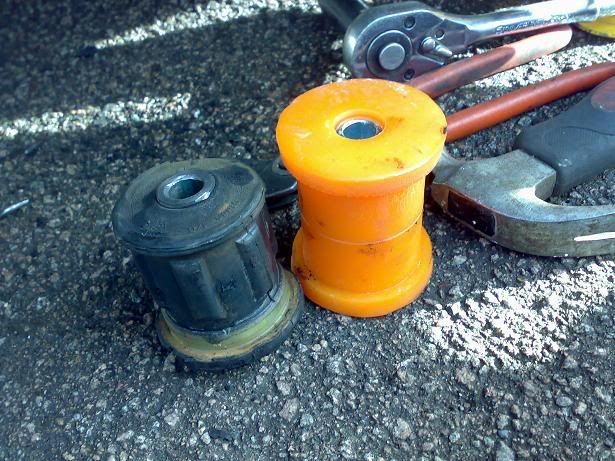

Then I thought I'd attack the rear beam bushes, thinking it would
a mission, turned out to be easier than expected, had a heat gun
but didn't really need it tbh.
old bush
hole :lol:
old vs new
Fitted:)
FOA Phil and whoever....
Feels much more stable at the rear now, especially when changing
direction quickly, I'd advise getting them if you are thinking about it.

PostPosted: Fri Nov 30, 2007 4:02 pm
:lol: loving the si after t cut looks great! :P
awesome as my si always felt skittish on the rear so handling has improved with the poly bushes 8-)
keep up the good work mate :)

Yeah, it's much less skitish, and generally isn't affected as much by
ruts in the road etc. :)

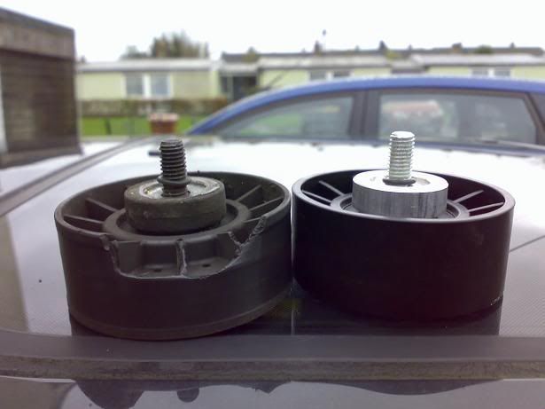

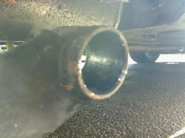

Well, I finally got around to replacing the idler pully on the
aux belt. £25 so not as bad as I antisipated, anyway just thought
I'd share a picture of my nakard one
:lol: :lol: bit worse for wear ey?
Emlyn
