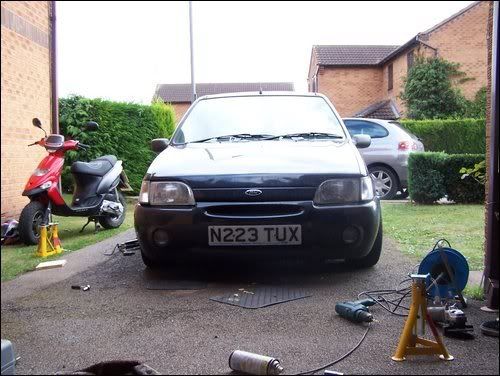

ok i was going to sell this but decided against it, and am going to carry on! it has now been lowered 60mm but waiting on some -40 spring still in post :x
anyhoo mods to date are:
ashley zorst
wheels
gmax shock and springs
panal filter (greens)
2i kit
and the usual stuff lol
mods that ive got and sat in my garage are:
c/l kit
wind deflector things :insanity:
2.0 mondy engine
im going to respray the 2i kit and rivet it on (so you can see the rivets on the arches) dont know how well that will go down but i think it will look ok.
Im after some cossie wheels aswel, do they come in different sizes or just 15''?? and problems with them on fiesta's such as offset etc??
cheers alex

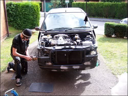

new wings and any rust a found sorted...
