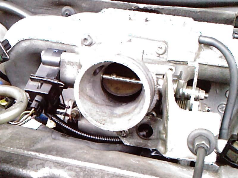

ok,
i've checked the hoses and pipes, no splits, all in correct positions (Can tell by bend)...
think i found the problem today....
went to adjust the accelerator cable, but first took the air induction system to see how far it was opening the throttle with foot down
seen it, laughed a little, must be half-throttle? thats with the pedal fully down...
so i went about adjusting and after some fiddling with no sucess i thought i'd ask you guys
i think i know what to do, but i can't be bothered to trial and error now..
the pic above shows the gromit thing, do i have to undo the nut before the gromit? then push /pull the cable? there is meant to be a securing clip i THINK for the gromit, but i've lost it when i swapped the head, think it's only to keep the gromit in the bracket though so wouldn't affect the cable...
so can anyone shed light on this for me...
thanks
..tested o2 sensor but unplugging it, in which i ran abit richer and abit faster but no doubt emission would have been v.bad, therefore i think the o2 is working fine
cheers
andy
L333SYA - Ford Cougar 2.5 V6
RR - TBC
PostPosted: Wed Jan 09, 2008 2:41 pm
You need that clip thing to stop the cable moving within the grommet
