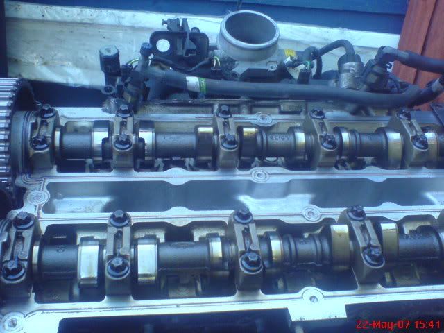

well i did cambelt on the 2litre mondeo engine and old belt was loose as i undid bolt it slipped so cams went out of align !

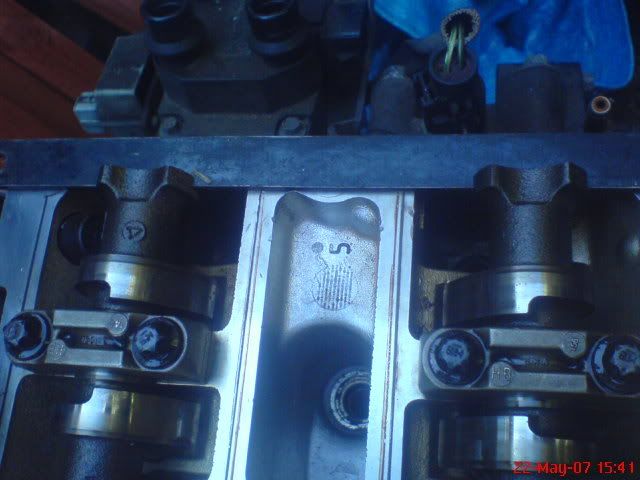

after getin cylinder one to tdc ! i got cams locked at this position and im wondering if they are right !
i got key way on the crank pulley dead upright facing the sky !
heres some pics first of cams under oil cap end ! exhaust !
heres pic of both cams aswell

The cams are right provided the bar is a nice tightish snug fit, but the crank timing mark on the crank pulley must be inline with the web on the sump and not dead straight up.
