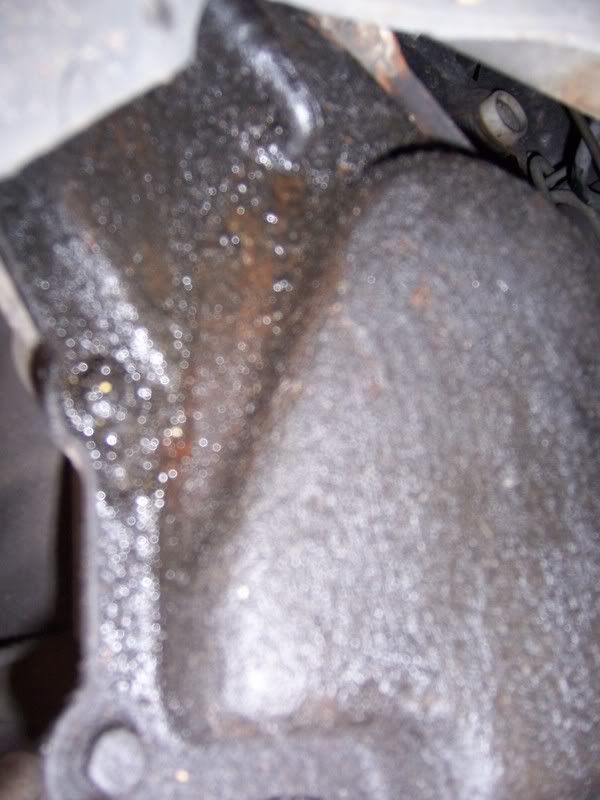

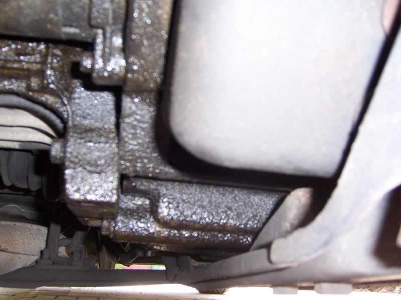

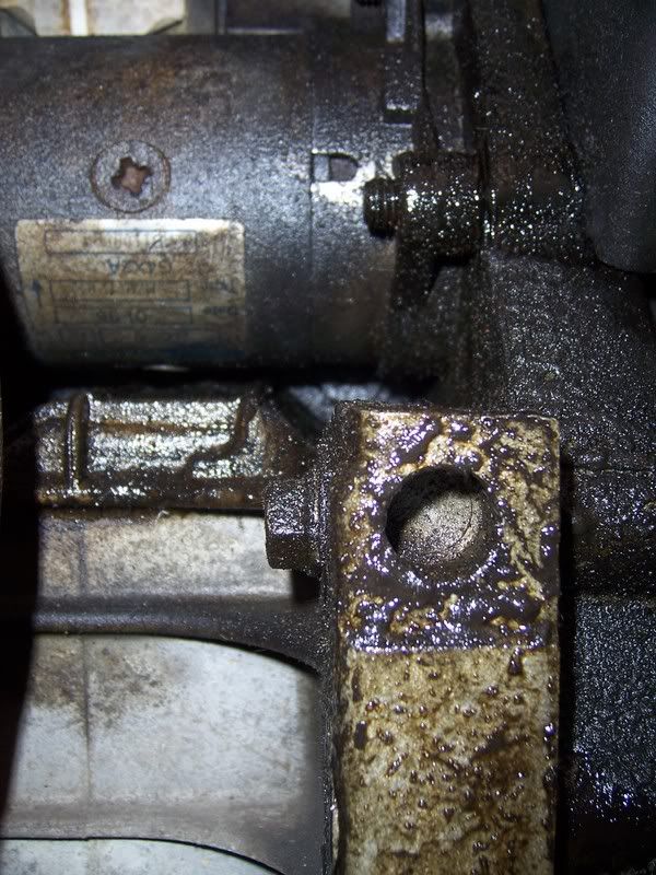

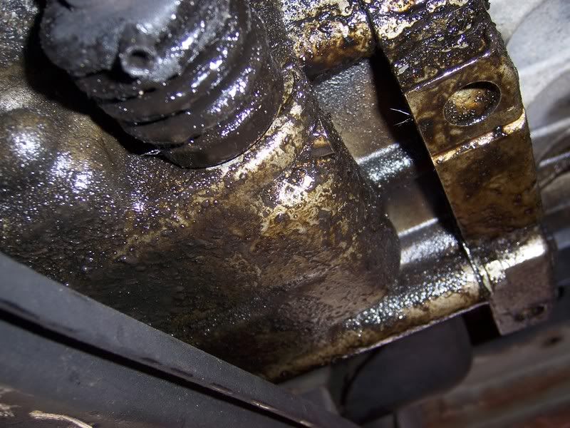

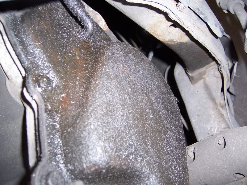

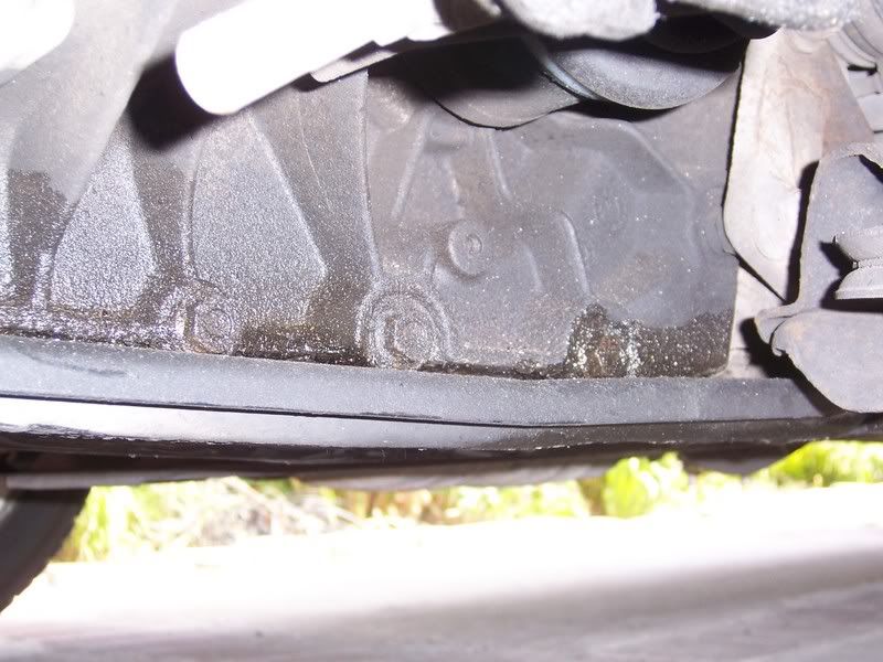

well i dunno where its goin but its definately got worse ova past few months !
i would say tht ive used about 4litres of oil since november last year ! when i got the car !
i thinks it engine oil as thats wat im having to top up and not gearbox oil ! but i shall check gearbox too though
heres some pictures for any tips and advice please
thanks
garry
sorry if too many images just thought it may be easier !
hope somebody can tell me where i could be comin from

Does also look like a old leak with the amount of dirt etc on it.

Id say crank seal, this happened to one of my mates cars last week!

u could always degrease engine bay and see what happens?
PostPosted: Fri May 04, 2007 8:45 am
i said that too mr phil :), steam clean/degrease the lot then drive for a few miles till its up to operating temp (as thats when everythign will be nice and loose)
then go home and park up and have a gander (take some pics too)

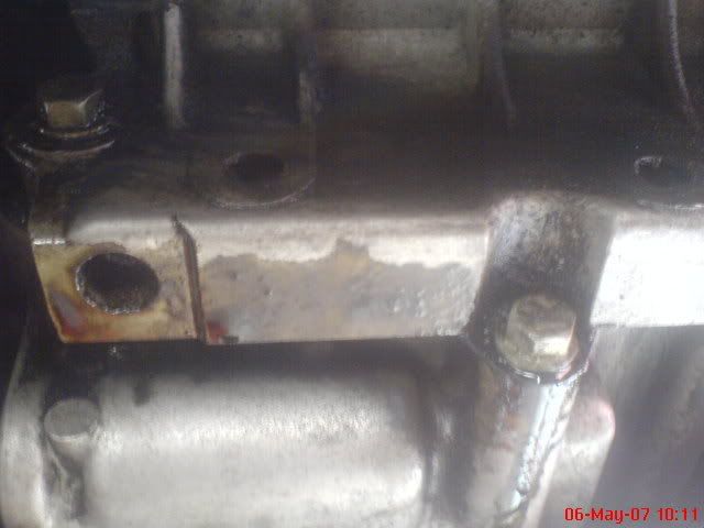

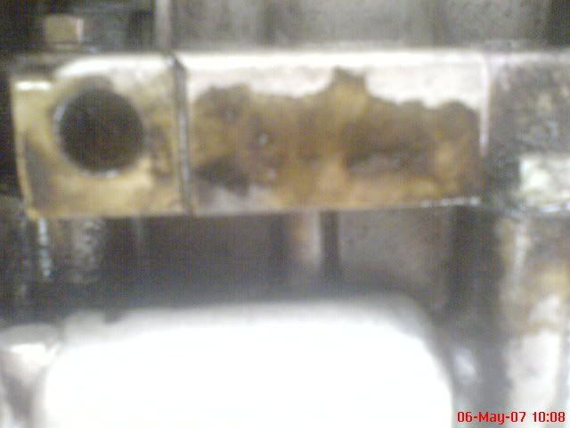

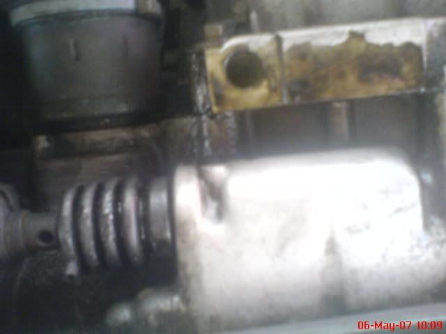

well i cleaned it up as best i could and this is what and where the oil as reaappeared !
oil has reapeared near the side of sump nd gearbox where they touch and theres a metal plate !
Image#
oil has collected around tht screw in picture one
