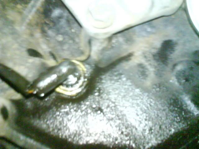

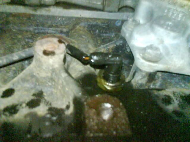

hello iv had an oil leak on my car cince i bought it and i always thought it was the sump gaskit but when i was under the car today doing my exhaust with an inspection lamp i noticed that it was comming from a sensor can anyone tell me what this sensor is and if i remove it will oil come pi**ing out of it lol
its just above the sump on the back of the engine, pain in the arse to get the camera up to lol

 Post subject: Pressure sensor

try not to use silicon in an area like that. so easy to get picked up into oil system

oil pressure switch is the name

Yeah Moe PTFE tape wouldn't be a bad option at all and it is dirt cheap
