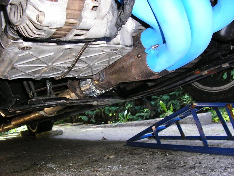

you can buy flexi's and lambda boss' off ebay for near nothing then you can just put the flexi underneath the engine where the down pipe meets the exhaust system.
heres a quick pic of mine when i was making it up.

oh, the flexible joint where the manifold and downpipe meet.
TBH cant see that moving tooo much.
you can fit a flexi pipe to your exhaust though
something like goaty has
JJ

Hey,
Its a Tony Law manifold, and yeah it can just be pulled off. Its a pain to do but it can be done and the standard manifold and downpipe with cat can just be bolted on.
Works really well just it really is a pain to remove as it tends to stick together and you have to work it off slowly and patiantly.
