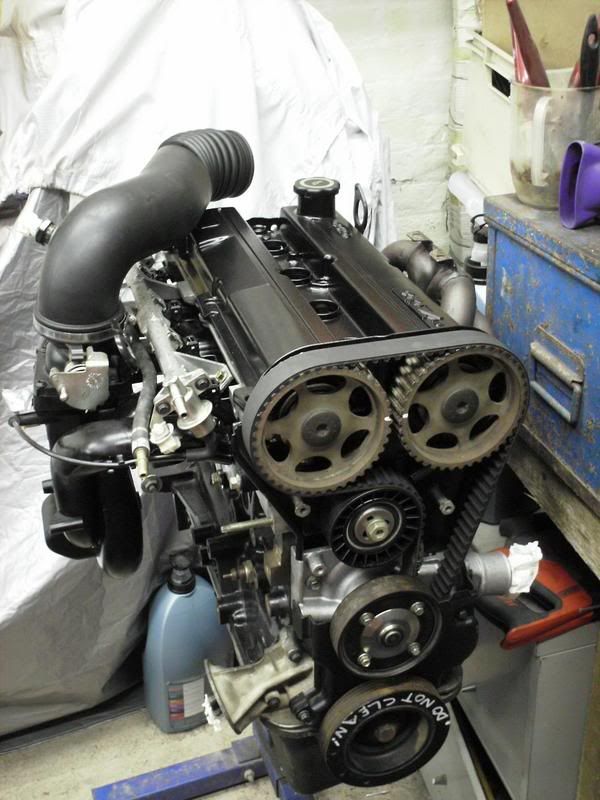

Hi Guys,
As some of you may know i am currently building up a Series 2, 2.0L Zetec Engine for the standard Si conversion.
However, i use my car quite a lot and am in a bit of a pickle as to what gearbox/driveshafts to use? :-?
I was going to use the standard Si gearbox at first, but after hearing several horror stories with them not lasting long, I am now not so sure. I want to do it all properly and was wondering if a standard Escort RST gearbox (With LSD) would be a straight swap for the Si box to the Zetec? Or will it need modification? Also are the gear ratios a lot longer than the Si alternatives? As I will definately be wanting acceleration over top speed. Anymore gearboxes that would suit the bill? The LSD would be handy to have from a handling point of view, but is not essential.
I JUST NEED A RELIABLE GEARBOX FOR THE POWER OUTPUT OF THE 2.0L, WHICH FAVOURS ACCELERATION OVER TOP SPEED.
Any help would be very much appreciated guys, many thanks
Dave :)
