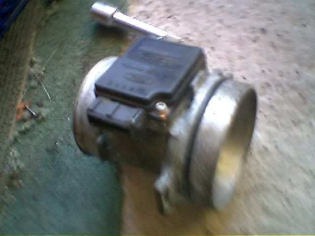

As for my MAF ill thank you not to delve in to my personal life Matt!!........lol, no but seriously whats a MAF?? :insanity:

MAF = Mass Air Flow sensor

looks like this just air box on one side and tube to intake on the other :)

Ahh cheers for the Pic i can see it now!
