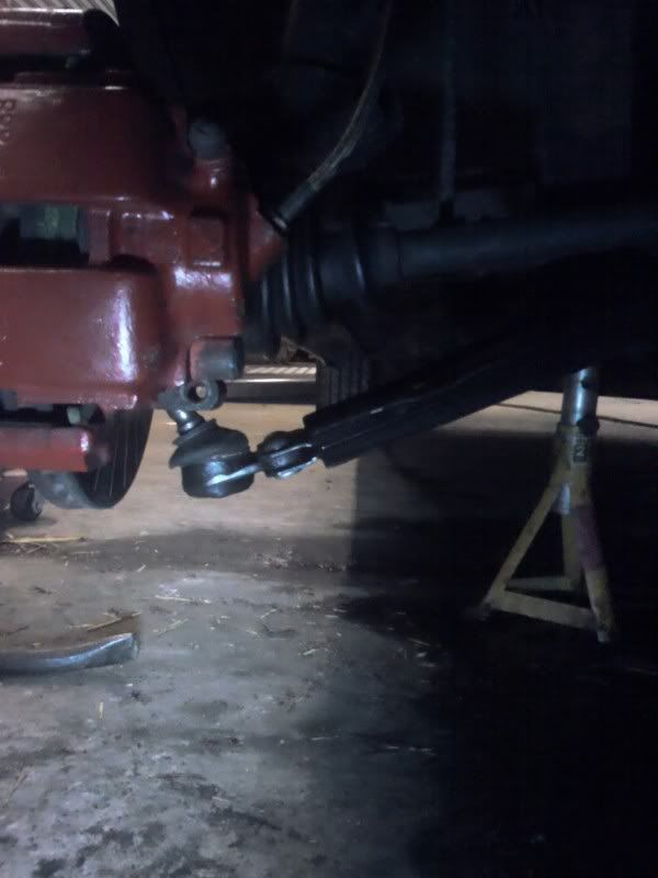

Right, went down after work.
Alot of head scratching!
Got the shafts in the box fine, ns hub done.
This was the os:
Had to drop the shock off the hub and loosen the top, put the ball joint in first, then with the use of a jack to get that sorted out!!
I have a feeling they might be the wrong wishbones, had a similar problem on the pickup once before...
But it is done.
