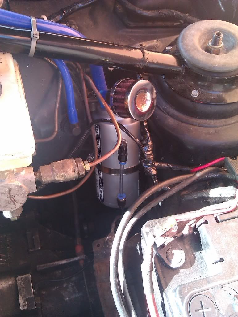

does it look like this in the top right of the picture? if so a modified engine breather if you have removed the air box? i fitted mine vertically to reduce oil cary over, if lots coming out could be over filled with oil, blocked crankcase breather or rings getting worn.

yeh thats it its on a long pipe though and sitting on the battery tray would that be making it leak?

which route does it take? better to route the pipe upwards then filter on it so any condensed oil drains back rather than down to area of airbox
or as said fit a oil breather catch tank which is what ive now done
Will
