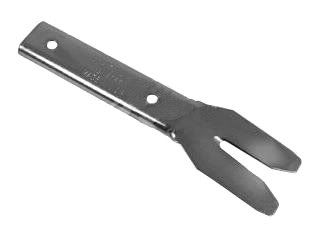

did it look ike this

Oh crap i forgot to check what page, its a whole section about removing/fitting body parts. I dont think that looks like it, i will find a pic for you.

Btw the pic of the tool you have put up thete looks more like what yoy usr the get the clip off to remove the window winders

Yeah that is a clip remover.
The best alternative to the tool described is a spanner. 11mm, thin but strong. Needs to be long too, which is incredibly rare. Then bash like a madman with a hammer. After removing the clip at the other end of course.
Other methods are heating and using a chisel to knock off the head then using a punch to push the pin through. Obviously this method needs you to replace the pin, lol.
