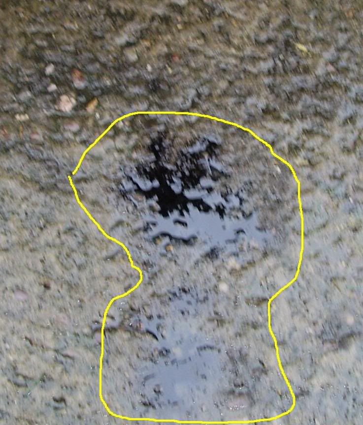

This has been scaled down cause of its size, but when i pulled the car back yesterday morning this patch of oil was the size of my trainer and half the other one, and i have size 11 feet !!
Don't know whats wrong, its really low mileage, i heard a funny bump the other day, it is low, about 60-70mm all round on 14 inch steelies?
No oil registering on the dipstick now and its a little tappy when cold so i guess its emptied itself quick, on the drive and the car park at work :(

If you had a little bump have you had a check at the sump? Maybe the sump plug came loose a bit to allow alot of oil out gradually?
Only thing you can do is get under the car and have a look for any obvious damage. But dont drive it without any oil :oooh:

as above and check the sump bung and the oil filter are tight
