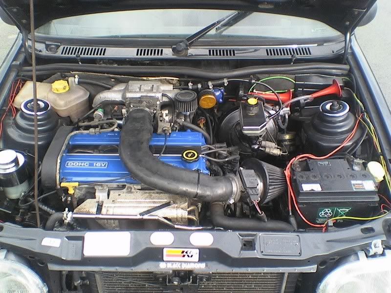

where do i drill for the live wire to feed through the car i know it the firewall but where as dont wanna drill into summit important
pics of where your power lead goes wud be good :)
PostPosted: Sat Jun 19, 2010 11:47 am
in the passenger footbwell (assuming you have an si..) Just make sure you don't drill through where the wires are, its not very busy in that area anyway so you should be alright, thats what I did with my two.
PostPosted: Sat Jun 19, 2010 11:50 am
The best think to do is to run it around the back of the engine bay to the big grommet behind the header tank :
Its hidden most of the way, but basically the top left is where it enters the car, it will drop into the drivers foot well from there and the rest is history.
