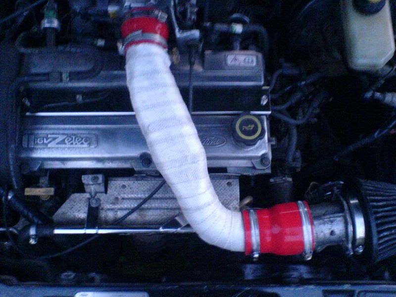

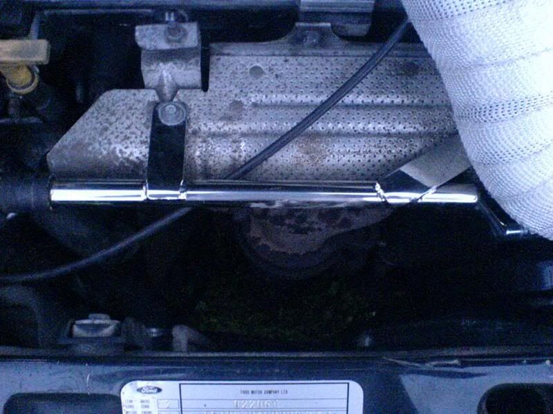

Here's the pictures of mine when i had a S/S water rail

I was using oe hoses, so just cut off the metal coupling and pulled it on the rail and used a hose clip.
