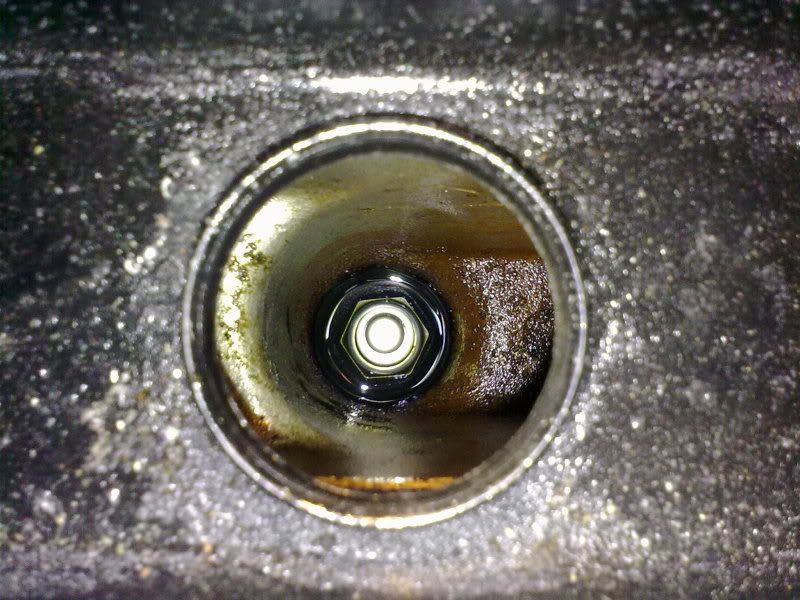

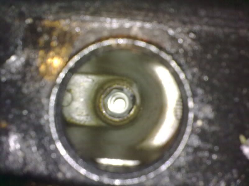

It is also stalling when coming to a stop every so often and I took all the plugs leads off. Plug 1 has oil in it, Plugs 2, 3 and 4 are all dry

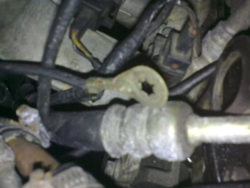

Also this earth lead seems to not be connected anywhere, it is connected at the turret but nothing on the other end
Scott

have you removed the spark plugs themselves? take each one out and get a pic up
the earth should be attached .

the oil could be from filling it up and a little has dripped into the recess

ye earth goes to the lifting eye

I'll put the earth back on tomorrow, it has been off since I picked the car up so cant imagine that is causing the problems but I will get it done

I've replaced the coilpack and fitted the earth lead this morning

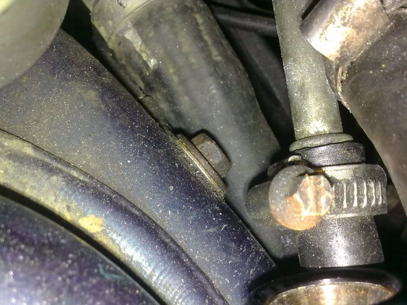

No idea about the lambda, i'm not even sure if one is fitted and cant get under the car to have a look at the moment

the oil around your plug could be the rocker cover gasket leaking?
iirc you should be able to see the lambda poking out if you look down by the rad, water pipe side i think

I think it could be the rocker cover gasket leaking and the oil around the plug is stopping it from firing so the fuel is not being burnt so more fuel is going through as its not being burnt properly
I'm going to clean the oil out from that plug at lunch and see if that makes a difference and if it does illhave a look at the cam cover gasket and get another one
