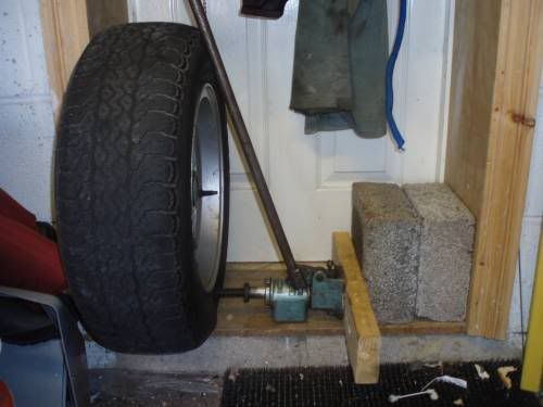

removing tyres is a very difficult DIY job, firstly braking the bead but then leavering them off, picture from another forum on bead breaker but best done when no one else at home!!!
Will
