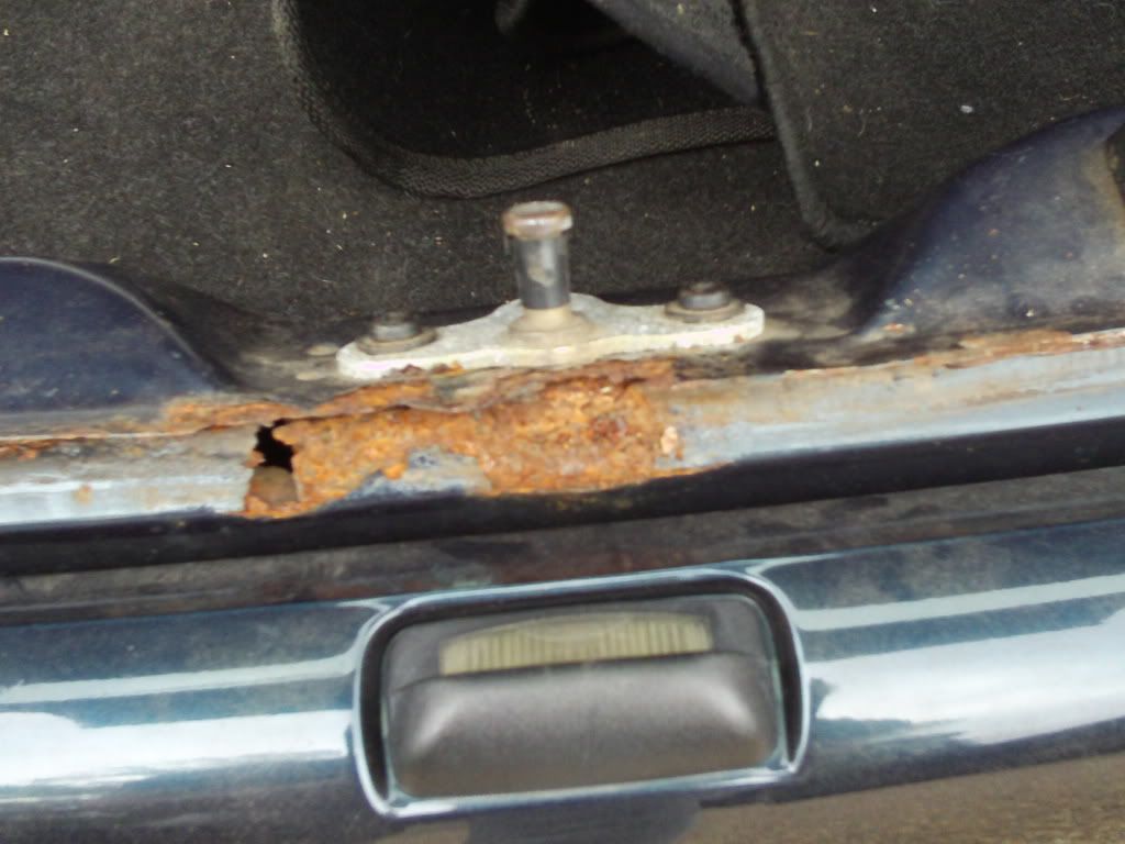

Basiclly were the lock is on the boot, i got a whole bit of RUST. Quite alot, and occasionaly water gets in.
Garages are quoting me £300-£500 to fix it, is that about right price or could you advise me to do anything else ?
Cheers
If anyone lives near KENT & is good at wealding and rust restoring, please contact me

I ripped up the carpets & the major rust bit is on the boot.
Everywere else is actually fine, under the car, under the carpet in the boot, under the seats under the carpet is all alright :0
So could i just weald a plate going along the rusted bit at the back ?

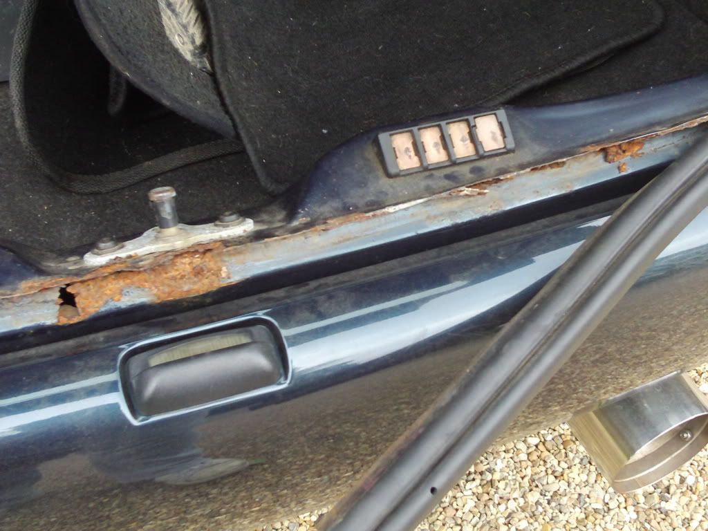

Here it is :/
Trying to find the cheapest way possible.

have you had the rear bumper off to see the rest of the panel?
that could be plated but you prob ave to cut alot off due to the rust, but good thing is it wouldnt need to be painted to match as it wont be seen with the boot lid closed
