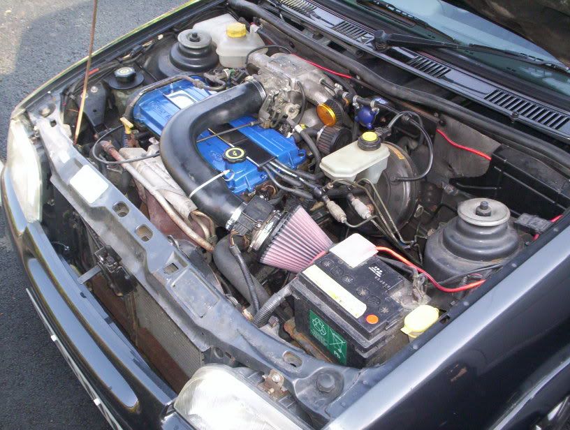

PostPosted: Thu Oct 23, 2008 12:58 pm
Best pick I have:
See the red wire from the battery, run it right around the engine bay (as seen), root around behind the header tank and you will find the grommit, get it through and it will be in the drivers footwell, run it up that side into the boot :)

Ahhh nice one mate, so do you have to run it back on itself again once youve been around the engine bay inorder to get it behind the header tank?
PostPosted: Thu Oct 23, 2008 6:27 pm
Not really, if you undo the nut which holds the header tank you should have a clear(ish) view of where to put it.
It goes without saying that the last thing you do is connect it to the battery.
