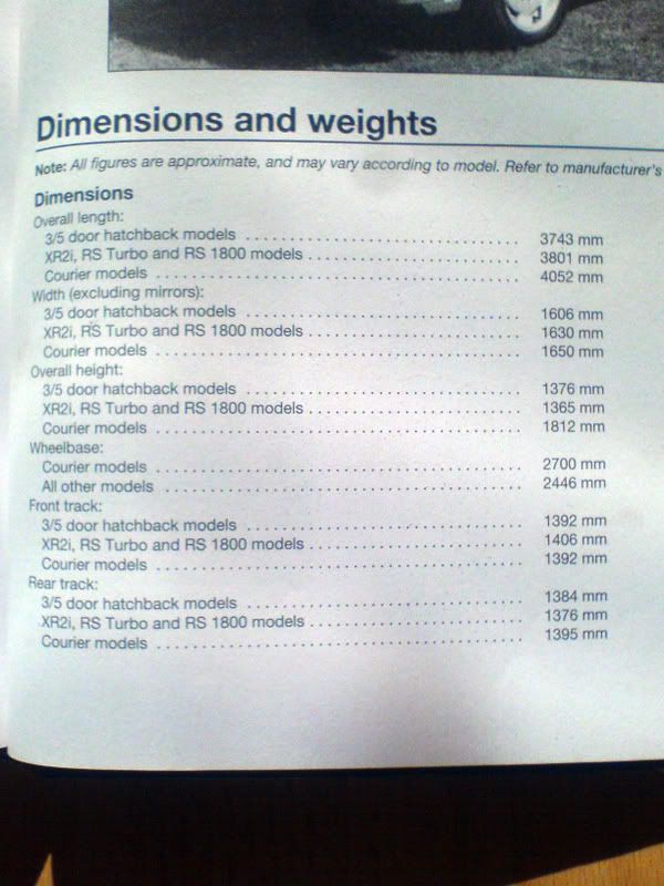

But I'm want to know the size of the mk3 Fiesta Courier van... I'm sure apart of them is longer than a standard mk3 fiesta shell??
So if anyone can find me the info on them it would be much appriciated, I would do it but I am at work and cant get access to all the net right now.

Instead of copying it out, i thought i would take a pic, easier lol. Also you can compare :)

Cheers :thumbsup:
