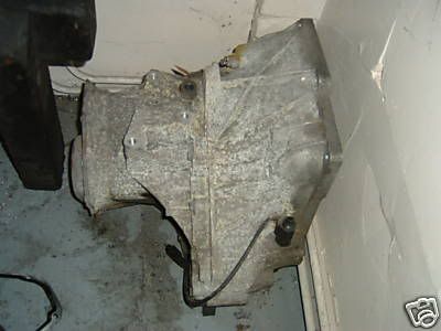

Just wondered if some of the gearbox gurus could tell me if this gearbox will fit in my Si
Its from a mk4 Escort Diesel van and im planning on fitting it with my 2.0 engine to increase MPG on the motorways
Scott
PostPosted: Tue Aug 26, 2008 12:49 pm
Yeah it should, as the starter motor should mount at thefront as your Si one does. I was thinking about this for my xr3i mk4
PostPosted: Tue Aug 26, 2008 1:12 pm
Sure will, i had one on mine for about a month and a bit before i blew it up! :lol: :thumbsup: :halo:

Does anyone know if this one will fit in my Si
Its from a Escort Van
Scott

Is the above gearbox still a BC box or is it a IB5 box ?
Does the starter mount on the front still ?
Scott

Cheers Paul
The photos make more sense now but as long as this is the same as the one you have fitted i see no real reason why it wont fit my 2.0 engine
Hopefully be able to collect it at the weekend and get on with fitting my 2.0
Still cant decide whether to go for throttle bodies first though and then drop it all in as one
When you fitted your diesel gearbox did you manage to keep the original gearbox cradle or did you have to change that to the diesel item as well ?
Scott
PostPosted: Thu Oct 09, 2008 11:49 pm
The cradles are the same for the fiesta's... I think I currently have a diesel cradle tho.. only because I couldnt be arsed to fit the one that was on the RS box :lol:
