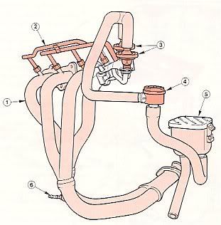

the system in which people are refering to as EGR is this system marked 2 correct? (this is an rs2000 manifold but just imagine a zetec cast manifold rather than a tubed 4 branch)
if this is the case this is NOT an EGR system.

We will start with the APS and below is a diagram and a list of parts:
1) Manifold
2) Pulse air tubes
3) Pulse air valves
4) Air control system
5) Pulse air filter
6) Lambda/hego sensors x2.
