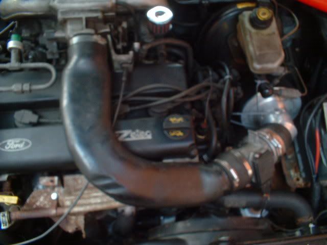

ive no idea what induction pipework i have on my 2litre conversion but as the picture it looks quite small and wondering if its restricting the power, what is every one else using?

thats the k£n tubing that comes with a 1.6 si induction kit i have hered that these offer the best power unless u try getting a custom samco one made (expensive) stick with it m8 they work well

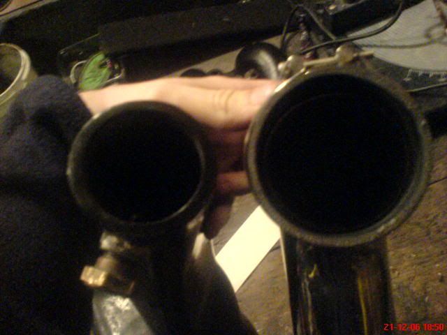

Walla, thought i had a picture
ERST on left, CTR on Right
Remember Boosted are pushing the air through, but NA is having to suck it through, so makes more sense to have a larger piping (but not to large), CTR piping was about the same size at the 2.0l TB! :)

If its fine for the rst, it'll be fine for 130 bhp at 1bar as the vacuum produced by the combustion process draws the air in. Thats how MAP reaches 1 bar at WOT.
The reason your latter one was tourquer was due to the angle reduction in the pipework, not the pipe bore :nerd:
