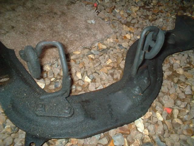

Yes i know im missing a clamp in the middle :red: however it all seems to be hanging very low, with the car sitting 40mm lower and the anchors at the front im catching this all over the place :(
I dont know how you guys run 60mm but i dare say somebody knows how to get my exhaust sitting a bit higher?
Cheers guys luvoo

have you got a front lower cross member fitted? it looks like you havent got any thing supporting the Cat at the front. there should be a couple of hangers with rubber doughnuts which support the cat with the hooks on it, as photograph it goes the front of the main body rails.

nope. had the car on the ramps and i have absolutely sod all to mount the cat on :( so ive made a mock one out of a coat hangar :(
Will try and nick the one off of dads as hes now got the escort :lol:

so has that lower cross member vanished? :o
