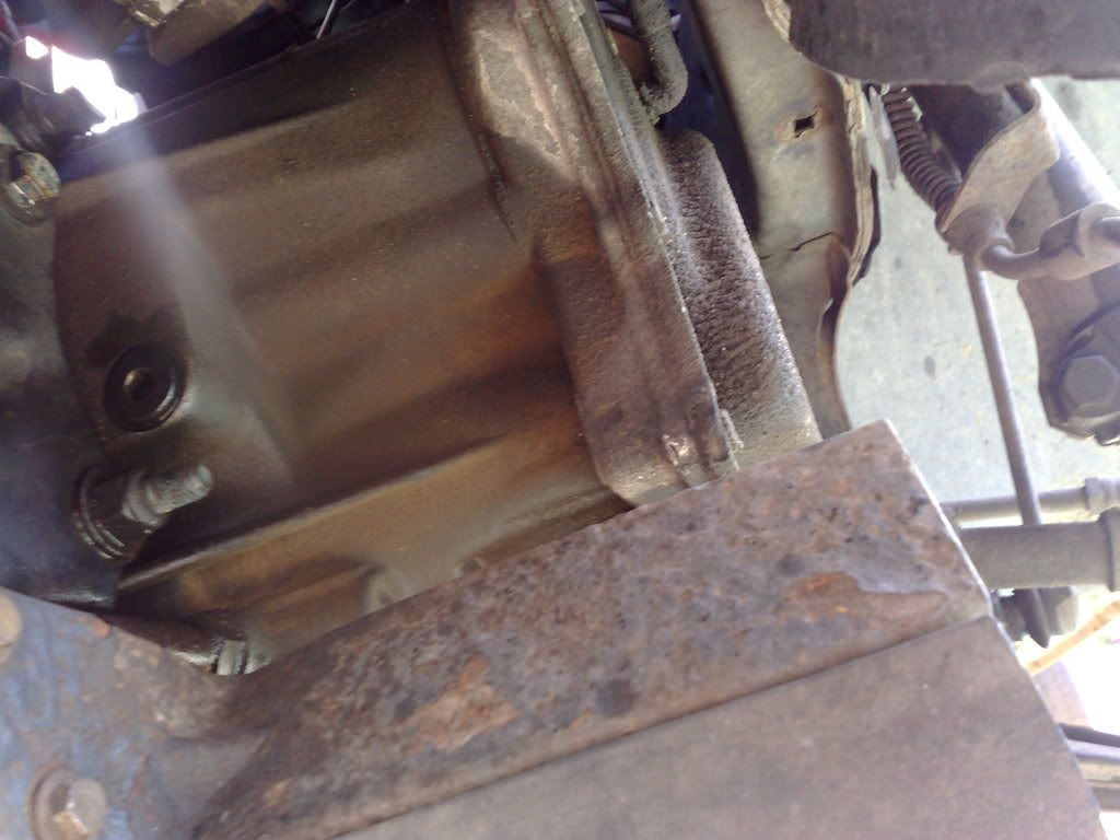

Recently bought a 1995 1.6 Si andbeen getting her upto scratch but encountered some problems recently!
In a quest of changing my gearbox oil I fear I have done something to 5th gear as now I can't engage it. (I later learnt there is no drain plug! so I guess whatever I undid is 5th gear related :(
5th gear will move to the correct position but it doesnt engage every other gear including 4th is fine
Anyway the question I want to ask is what does this bolt do because I'm sure me undoing this was the cause of it unfortunately! (yes I'm a retard I know & i will be more caeful in future!!)
Heres a pic, any advice greatly appreciated as I'm stuck now! Is it maybe worth removing the panel off the side of the bell housing and having a look?

That's not the drain plug lol. There's a plug to the left of that somewhere, possibly a bit higher (can't remember exactly where) that's a plug you can use to top up though.

Yeah i know lol, im a tard but i couldnt see any others!
So put it this way would removing that plug cause the problem I have described above with 5th gear?
thanks mate!

the drain is just to the left its the long plug (think its a 19mm) as for what you have done drain the oil and see what comes out (like small bits of metal)

yeah I saw that too which was prettyy much right next to it. but though this one looks more like a plug lol
Theres no grinding or anything so im gunna check the linkage first ie stick it in 5th and tighten it a little and see if that helps
I just cant see what removing that bolt could have done :? :( Maybe its just a coincidence
