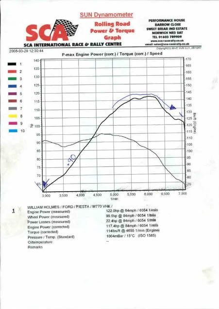

looking on a technical note when i fitted a straight through De-Cat pipe it increased torque but lowered the peak BHP down the rev range from 6000rpm to 5300rpm, this had the adverse effect of making the top speed slower but making the driving lower down the rev range better due to the increase of mid range torque up from 114 to 136 lbft. Are you looking at top end seems slower or mid range. i think the lack of the cat had a effect on the back pressure and and pulses in the exhaust
standard 2 litre with cat
Standard 2 litre with De-cat pipe
Will

Thanks for the Rolling road readings will121
there interesting,
yes the top end of the revs is seems really flat, like no power from 5000rpm up,
the car seems to pull through the gears slower to.
i've sat in the passeger seat and let other people drive, and well i dont feel like i am being pulled into the seat as much as before
(On my 1.6 there was power from 4k-6k it was pretty strong).
