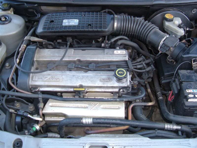

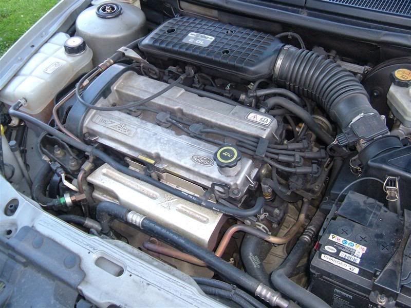

hey all i have a R reg mondeo with a silver top engine and a 2.0l of course can i use this to put in the fiesta or is the wrong series i have no idea what series mondeo it is tho so any help appreciated

its a silver top so all is good :chill:
its the series 1 and 2 your after(silver top) series 3 is the black top zetec engine :D

Get it out! (and in the fiesta)
Looks like series 2 engine, as series 1 had DOHC 16v on cam cover, unless changed.
