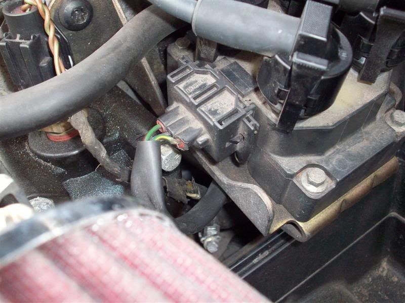

quite. i'll get a pic up and show you, it is really rather random though :look:

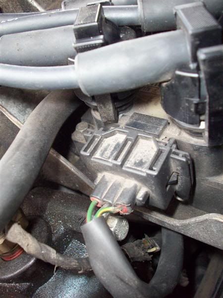

Here are the wires going to the plug that powers the Dizzy, think its obvious which one im on about :lol:

PostPosted: Tue Apr 15, 2008 12:26 pm
Fix that wiring up for starters before it gets really bad. Doesn't look tooooo bacd, but obviously being exposed isn't doing it any favours.

how would i fix that wire up out of interest because i was thinking of getting it done today but am abit of a newb with wires...

with regards to that plug, go to the scrappers and get another plug from a zetec engine'd car, fiesta escort mondeo. and cut off a few inch of wiring with it, then replace the plug completely and solder the wires together than wrap it up in tape. thats what we had to do for my iscv wiring :)
