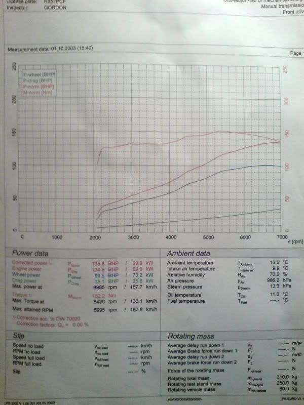

Air box the same as Percy has shown and a de-cat gave 16bhp. But then if you could only see the measures PeugeotCitroen had taken to dampen down the noise. :lol: No wonder I got a wad off power of it.
Oh by the way Mr Zetec, this is a semi-decent picture of my rolling road graph. Supply your before and after one of your £200 viper induction kit please :lol:
