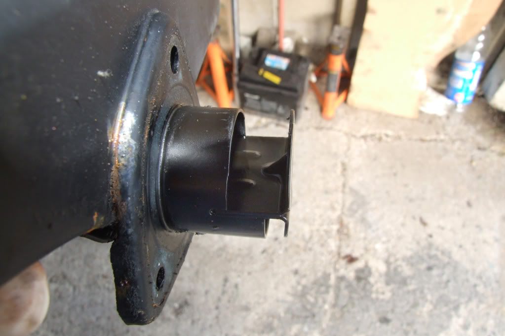

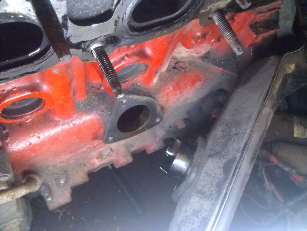

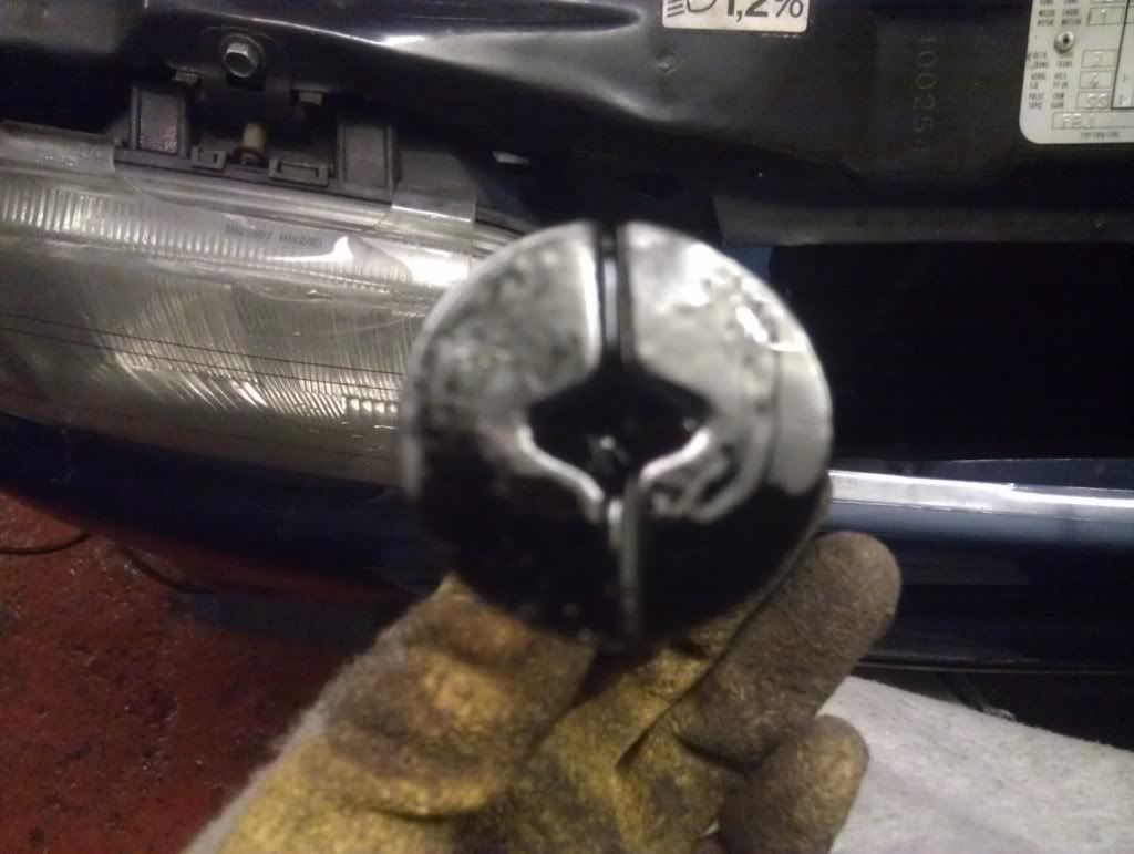

was removing the front crank case oil breather setup on my Zetec and found this weird blanker sitting in there, which has me confused s it seems to completely block it off
can anyone clear up what it is, does and should i leave it out as i do get a rough and lumpy idle, this would have an effect on that im sure?
would be ideal to know before tomorrow when i put the exhaust back on the car
PostPosted: Fri Dec 30, 2011 8:26 pm
As far as I'm aware that breather is one way, so could be to do with that
PostPosted: Fri Dec 30, 2011 8:59 pm
so it would slide in and out like a pressure valve?
PostPosted: Fri Dec 30, 2011 9:03 pm
It works from the pressure from the inlet, was only reading up about the breather system last week but I can't remember much at moment.
But basically, without it, it'll cause shit.
PostPosted: Fri Dec 30, 2011 9:41 pm
so leave it in you say?
PostPosted: Fri Dec 30, 2011 10:13 pm
I would yeah. Otherwise you'll end up shitting oil out at high load
PostPosted: Fri Dec 30, 2011 10:24 pm
could swear the breather thing is baffled, im verging on the idea of just blocking the fucking thing, so anoying

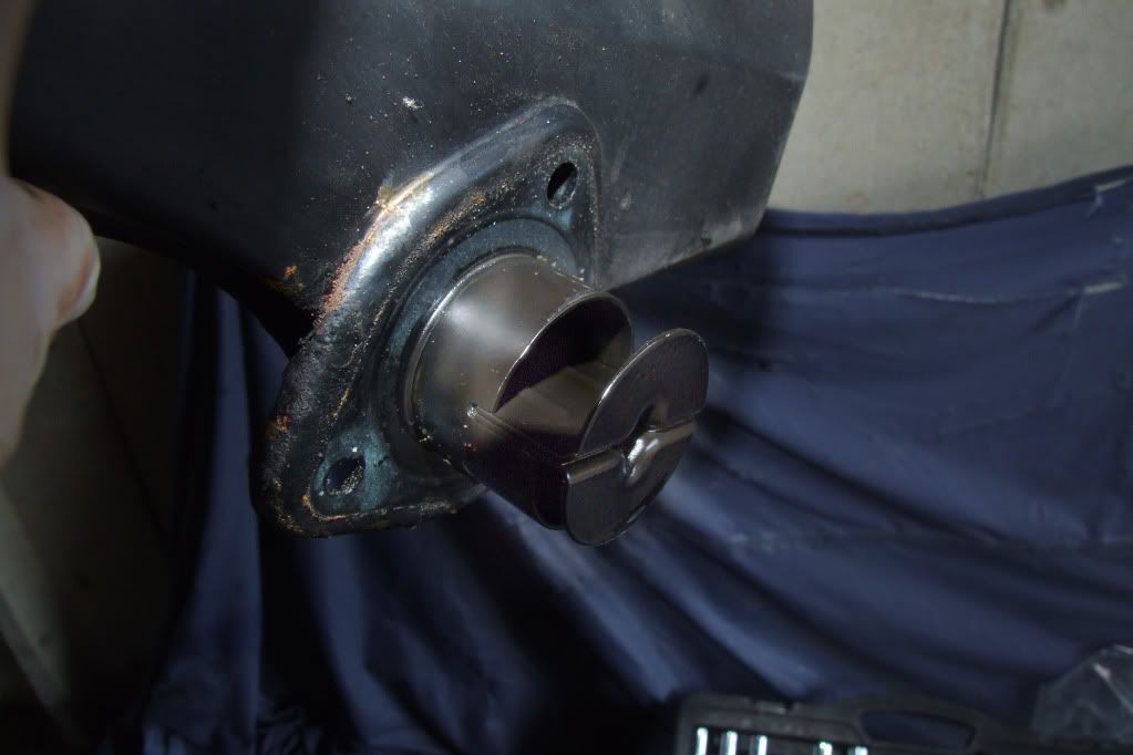

PostPosted: Fri Jan 06, 2012 5:57 pm

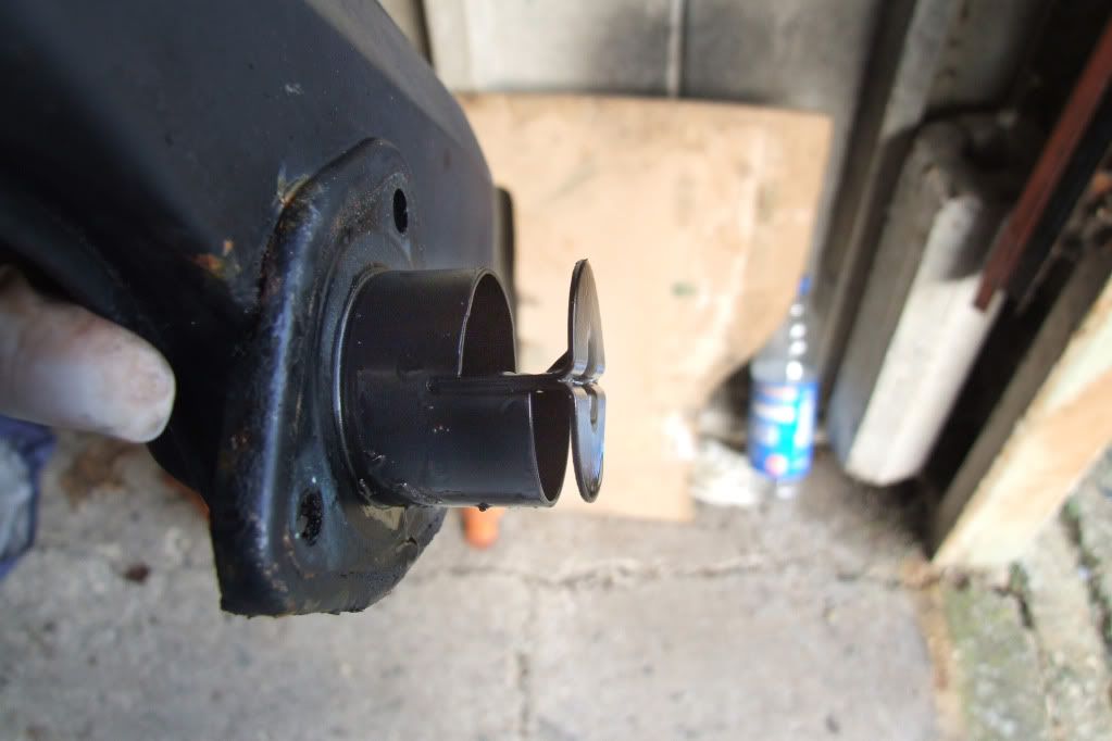

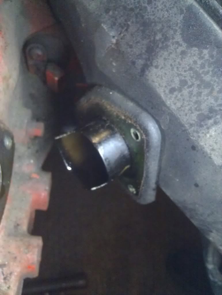

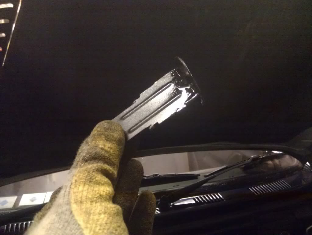

I think yours is slightly broken lol. This is mine from my 2 litre engine, took it out as im painting the block :)
PostPosted: Fri Jan 06, 2012 9:47 pm
aaaaah that clears things up, looking at that it just looks like a simple splash guard
thats put to rest my worries of too much oil going through my inlet, ill just baffle the pipes a bit
cheers man appreciate the effort :D
