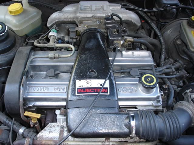

4) does anyone have any pictures of engine bays whether they are fiesta or mondeo with 1.6 1.8 and 2.0 zetecs in, i am particularly interested in the inlet manifolds because neither my si or the mondeo has the metal inlet manifold. but my si was apparently a 2.0 conversion but since taking engine out (i bought it seized) Have discovered its a 1.8, with plastic inlet manifold. many thanks in advance, please help me!!!!! :wink:

4) i dont have a pic of my engine bay but if you look in the members gallery( just had a look check the main site in the members cars JD Fiesta has a pic of his 16v Si engine bay) there should be some there, if not try and go to a scrappy and find a 1.6 16v Si inlet or a 1.8 16v XR2i inlet or a RS1800 inlet they should do the trick

no.4 standard 1.6 si :)
